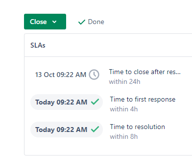

Sadly SLA timer still doesn't end. To clarify, it's the 'Time to close after resolution' timer:

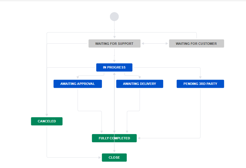

Also here is a screenshot of the workflow if that helps:

Luke Robertson
October 10, 2022
Boom! Thanks for directing me there. I just needed to changed the SLA configuration for the Time to Close SLA. It wasn't set to end counting when status changed to close. Not sure why it did work previously without the transition away from Closed but no matter.
