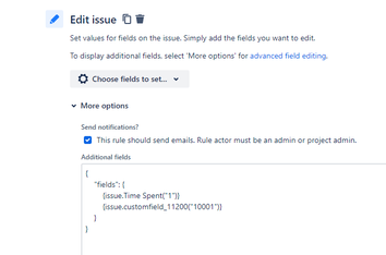

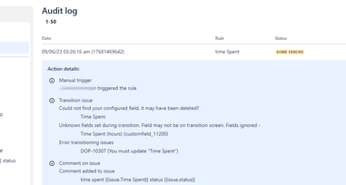

tried Transition Issue w/ JSON :
"update": {
"customfield_11200": [{
"add": {"id":"1"}

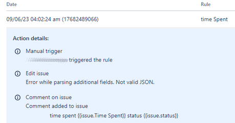

also tried to execute directly through JSON.
"fields": {
{issue.Time Spent("1")}
{issue.customfield_11200("10001")}
however, that fails also

Hi @Allen Semerdjian - Time Spent is part of a larger work log so a bit more complex than just filling in Time Spent.  I believe you need something like this:
  "update": {
    "worklog" : [
        "add": {
          "timeSpent" : "5m"
Allen Semerdjian
June 9, 2023
Hello @Mark Segall -   It Worked..! thank you. thank you
