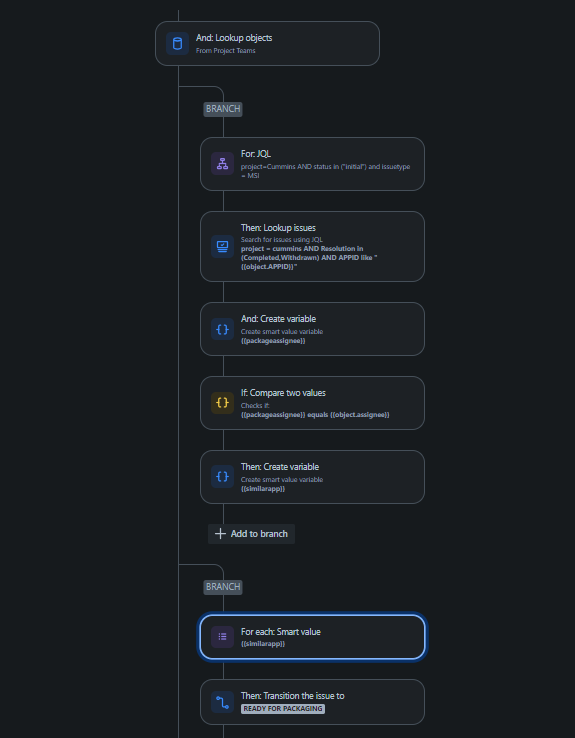

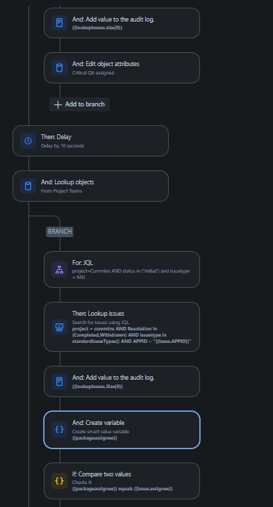

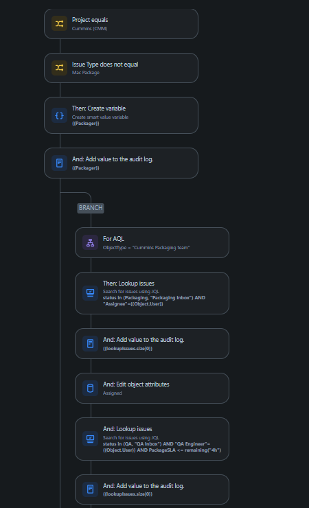

I am currently using assets to store the information about assignments so that i can easily query it based on other criteria's. below is the snapshot of my rule:
The rule is not fully completed yet and there might be some mistakes in it but in a nutshell i want to transition a specific issue based on the critirea i have mentioned above. do let me know if you have any more questions and i would be happy to answer.

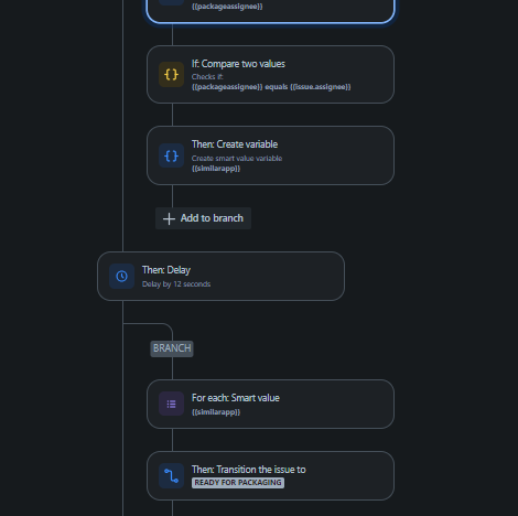

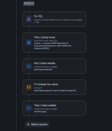

below is the screenshot of the rule on how it looks like:
1.) branch 1 - i am trying to search for the issue key using various conditions using a JQL search. once i have found the issue key i put it in a variable called similarapp.
2.) Branch2 - I want to transition the issue that i have found in branch 1 only and no other issue. However, I am not sure if its going to work or not ?
Is there anyway i can find a solution to the above problem?

The problem I see is that Branches don't wait for other branches to finish. So I assume there are no smart values to branch over at execution time.
You can check that by logging the Smart value with "Log action". Sometimes a "refetch issue" helps.

There are a few problems with the structure of your rule.
1. Branches run in parallel. You can CAN'T have one branch dependent on information from another branch. Refer to: https://confluence.atlassian.com/jirakb/in-the-automation-parallel-execution-of-the-branches-to-main-thread-can-produce-incorrect-unexpected-outcome-1115147731.html
2. Variables you create in a branch do not exist outside of that branch. You can create a variable inside a branch and then use that variable anywhere outside of that branch.
3. Can you clarify your intention where you are using a JQL based branch to select issues and then using a Lookup Issues action after that? The Lookup Issues action does not appear to have any criteria related to the branch you have started based on the JQL. By branching on a JQL you are telling the rule that there are actions you want to take for each issue found by that JQL. How does your Lookup Issues action factor into that?
Also, please share the details of the variables you are creating. That might help us understand your intent.

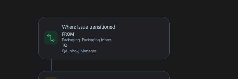

Sidharth verma
August 23, 2024
My triggering event is when the packaging engineer moves an issue from packager inbox to QA or Packaging to manager status.
see below:
