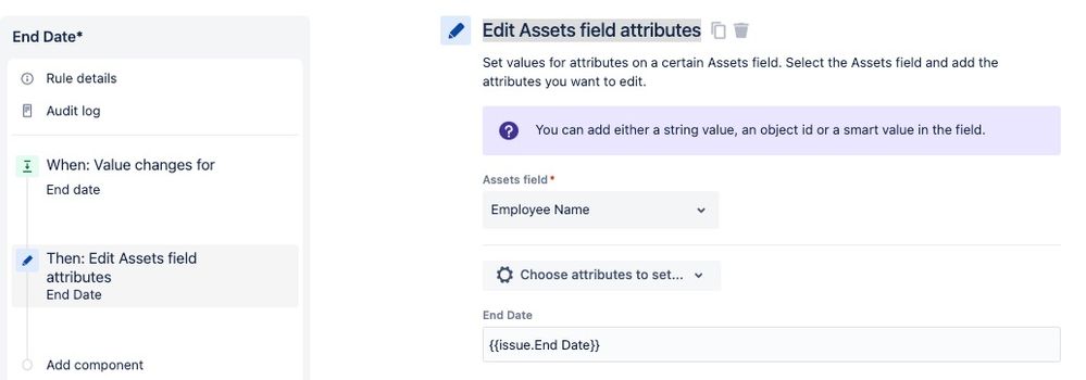

There is an action available to "Edit Assets field attributes," select the Assets field and then choose the attributes to set. End Date.jpg

Jenny Severin
June 26, 2023
I have built something similar to manage onboarding of our employees.
We use JSM automation to create an Asset when the onboard issue is created in JSM.
We have an Asset custom field called "Employee Name" that is linked to the onboard issue.
In the onboard issue, we use "end date" to capture the Contractors target end date.  If the end date is changed in the issue, automation will update the end date listed in the linked Asset.
One week before the target end date, the onboard issue transitions to an "Under Review" status and a task is created and assigned to the Manager in a separate Jira Software project so that they can confirm or extend the target end date.
If the manager confirms the end date, the onboard issue is automatically closed and the off board issue is generated.
If the manager extends the date, the end date is updated in the onboard issue (and in the Asset) and the onboard issue transitions back into a "Contract/Temp" status waiting for the process to repeat itself 1-week before the newly given target end date.
The onboard issue can be closed <manually> sooner, if necessary.
