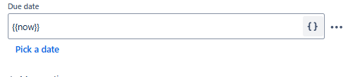

I am requesting assistance with how to fix the {{now}} JQL to consider the timezone that is set.
Currently the timezone is using GMT -8 however I am based in Melbourne Australia so the timezone is inaccurate so when I process a due date to be {{now}} the timeline does not reflect correctly.
As the above is a general question, I believe the Screenshot above would be sufficient enough to show how I inserted {{now}}.
I am unable to update the internal timezone as:
1. I don't know how
2. Not an option
So my question is:
How do I set {{now}} to be +8 hours to resolve the timezone issue which is GMT -8 ?

You can try the following:
{{now.convertToTimeZone("America/Tijuana").shortDateTime}}

Try to remove the time format
{{now.convertToTimeZone("America/Tijuana")}}
Joseph Khalil
February 24, 2025
Perfect that worked!
