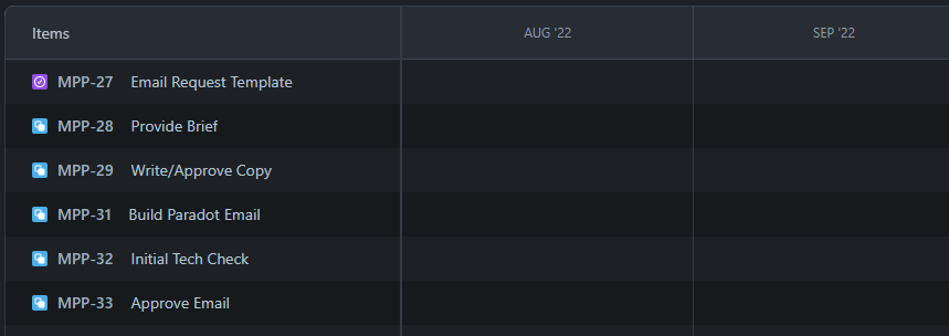

I have created a timeline view for a work management project and I want to see timeline for issues i have in 2018 but the last i cn see is upto aug 22
So how can I move this upto year 2018?
