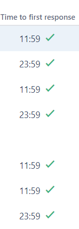

I'm currently reviewing the time to first response calculation. I have set an automated reply when a ticket is created to customers - so the first response is instant.
The conditions for the calculations that I've set are:
- Start counting when issue is created
- Stop counting when 'comment for customers'
I noticed the time to first response is always 11:59 or 23:59. What could me the reason?

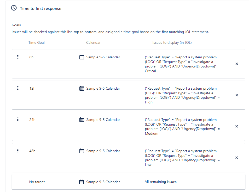

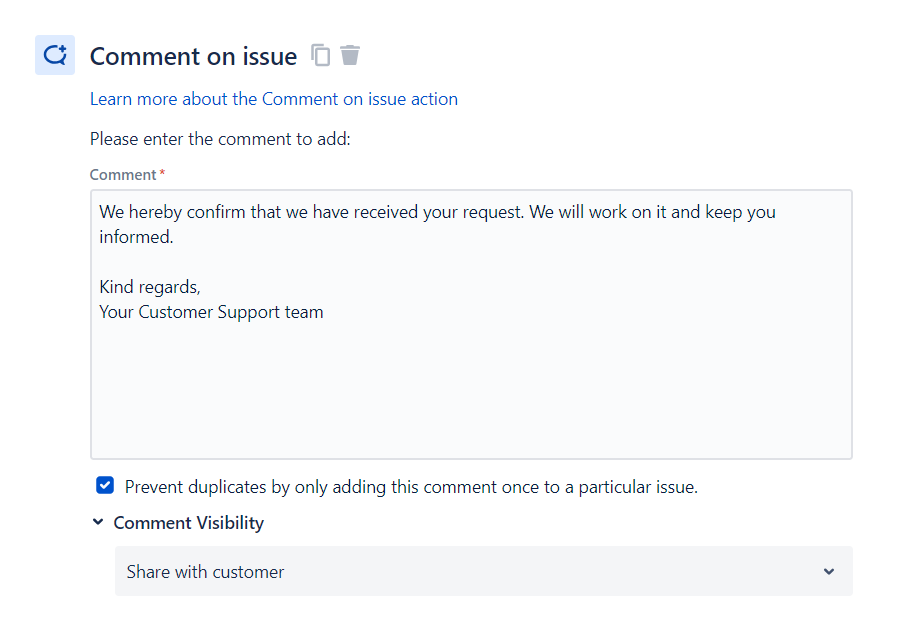

genevieve.vandenhende
July 11, 2023
Hi @Dirk Ronsmans
Thanks for your swift reply. Sure, please find them attached. Automation 1.pngautomation 2.pngSLA.png
Dirk Ronsmans
July 11, 2023
Without having a complete visual of your TTR screen could it be that those are just the "time remaining" of the goals?
Since you have a 12h and 24h goal I would assume these are stopped after less than a minute (since it is an auto reply) and thus you have 11h59m or 23h59m left on your SLA?
Like Walter Buggenhout likes this
July 11, 2023
You're completely right! I thought it would show the time the other way around - not the time left but the time it took to respond.
