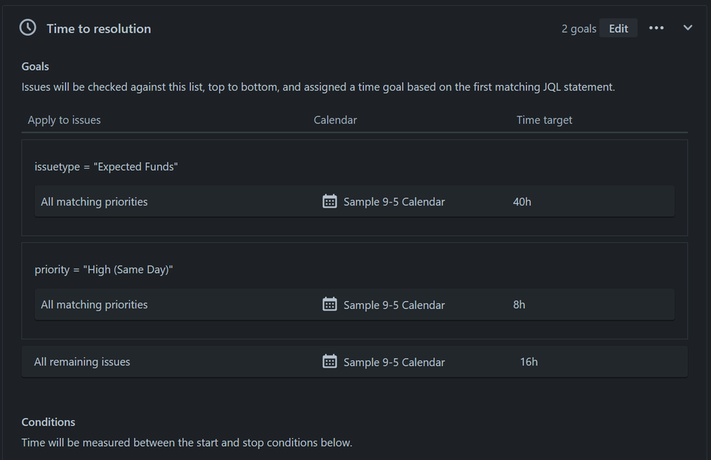

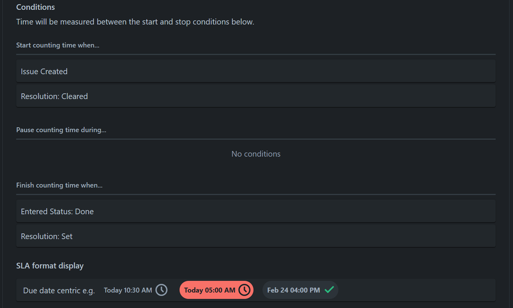

Riley Hosking
April 17, 2024
Thanks for your quick response @Walter Buggenhout !
Are the triggers you're referring to under the 'conditions' section of the SLA configuration? Here are the screenshots from each project.
Project A:

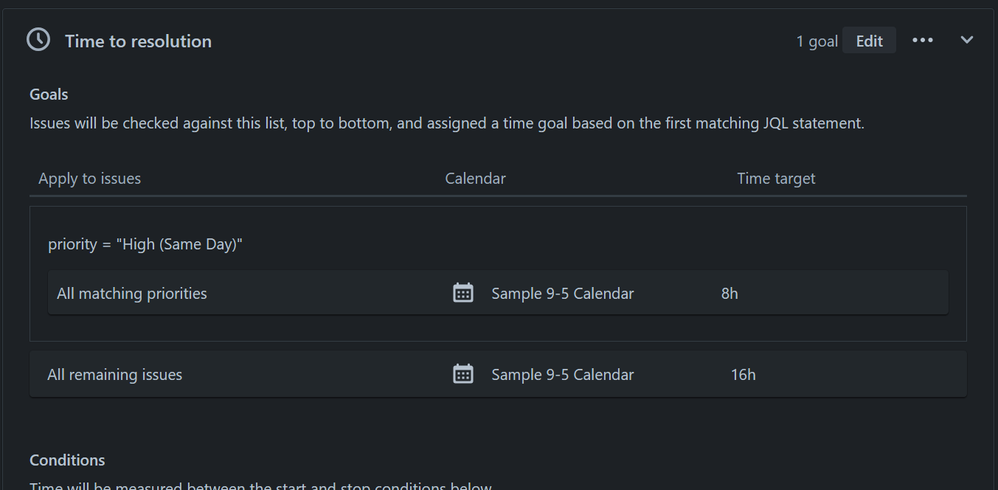

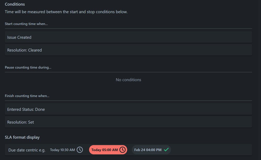

Project B
