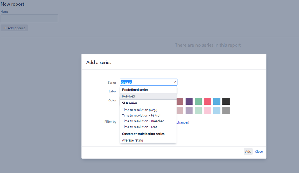

Hi @Romy Meyers. Besides what Fabian mentioned, you can also check if series are configured for your reports. Although it's one of the default reports depending on the template, someone might have removed the series from the reports.
In the report, go to the top right > Edit report > Add series. For more details on how to edit your reports/series, see:

@Ivan Lima thanks a bunch - yes i has to set the series up for the report AND it looks like i have to do this for every project - ugh?! and i do not see a global report area. however still not sure about the resolution field Fabian is referring to as i thought this report would go off of created and resolved date fields?! thanks again

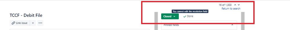

When you close your tickets, do you set the resolution field?

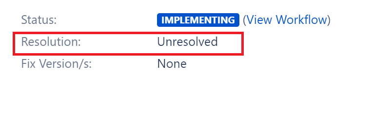

this is what I'm referring to:
Romy Meyers
October 28, 2021
@Fabian Lim so you see my status and resolution field - so it is getting set upon closing.

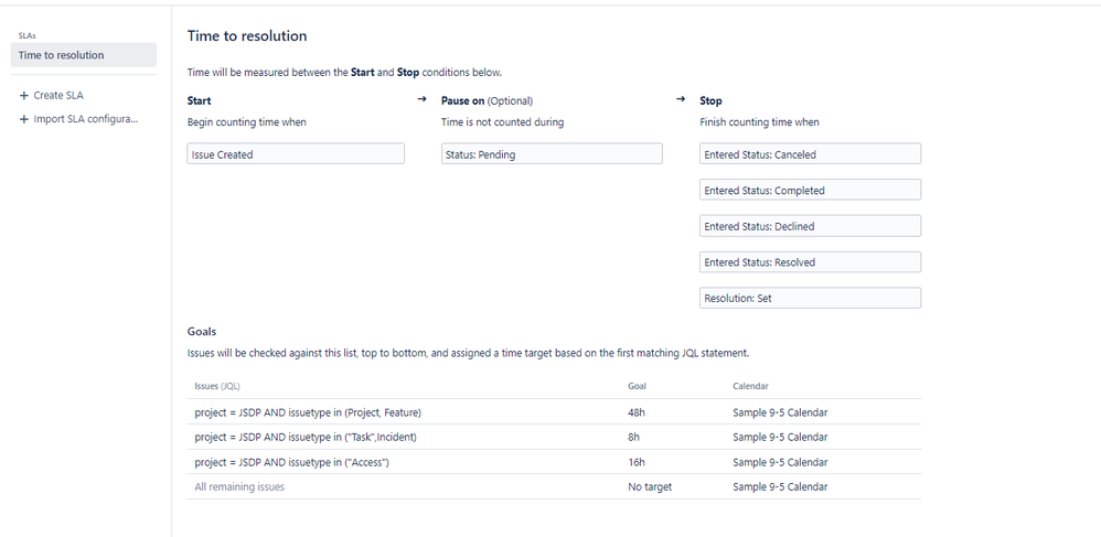

So you need to review this link: https://confluence.atlassian.com/jirakb/how-does-service-management-time-to-resolution-report-works-859509141.html
Make sure you set the the time to resolution in your configurations such as below:
Then you will see this option:
