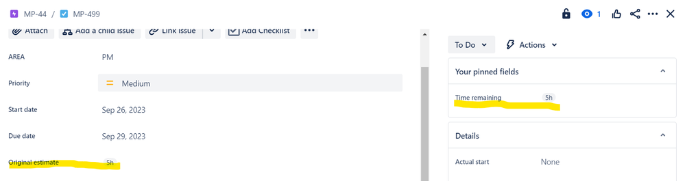

The Time tracking field used to work comparing Original Estimate against time entries (timelogs). Today we've found it only says "Time remaining" and we've to manually update that, we can't input the worked hours but do a manual difference between worked hours and the original estimate.
It's useless as it is right now, any reason why is working that way?

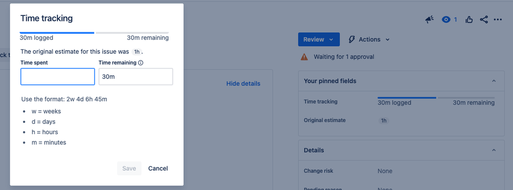

Hi @Juan Pais
Please make sure the Time Tracking and Original estimates are on the context fields.
The field still relate to each other, see below
Juan Pais
December 6, 2023
I've both fields, and it worked as your screenshot until yesterday; now I'm seeing this time remaining thing (kinda useless) in all my projects/tasks without changing anything in the task fields configuration.
Still able to load time on timelogs (activity section in the task) but that won't affect the time remaining.

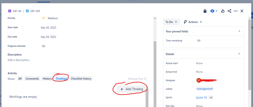

Juan Pais
December 7, 2023
Yup, still able to log using timelogs and the timespent is getting registered, I can see it exporting the issues, but the time remaining isn't updating and as you can see, isn't working as in your example (it worked that way until a couple of days ago).

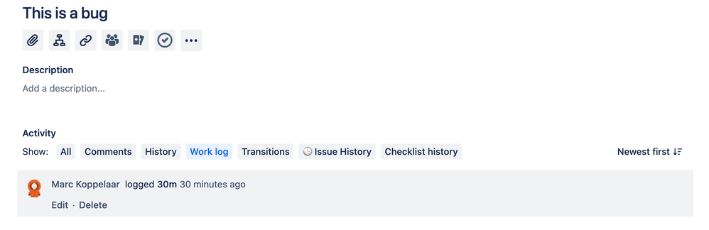

Time logged by Jira default ootb Time Tracking shows as follows
The tab logged work is visible under within activity is "worklog" and not "timelogs".
So check what marketplace app is used with your "IT guy", as it is definitely not the ootb that is used.

Thiago Pinheiro
April 10, 2024
@Juan Pais were you able to revert it back to this way? please see image below
