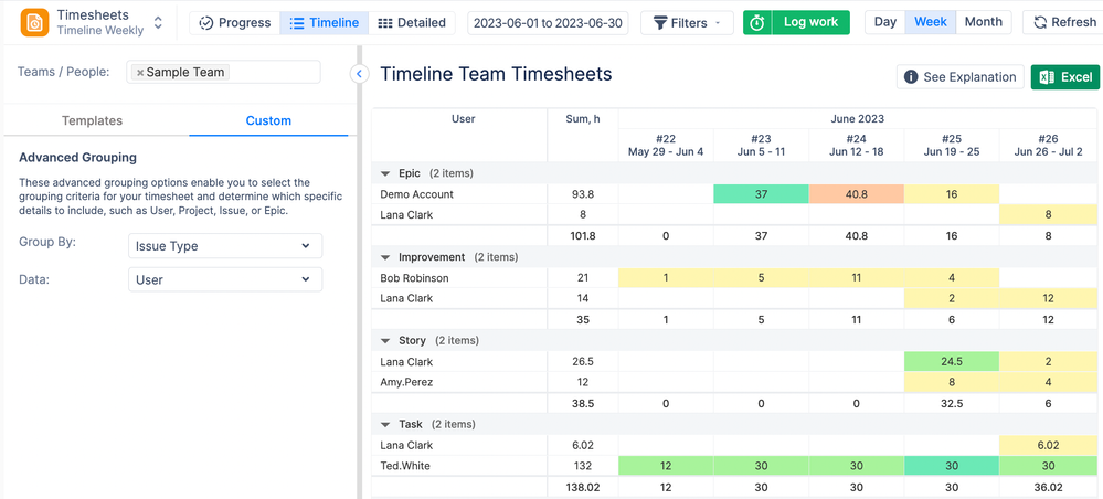

I can suggest you ActivityTimeline as an alternative. It's a bestseller plugin for capacity planning and time tracking in Jira.
There are 3 Timesheet Report Templates in AT: Timeline, Progress & Detailed. They work on the principle of the constructor – just choose the needed values, click create and receive comprehensive information.
Here is the screenshot for your specific use case.
Feel free to ask any questions or book free demo call to discuss how we can help you specifically with your project:)

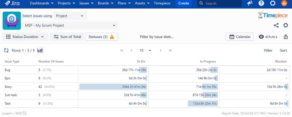

I didn't understand from your question what method you use to keep track of time spent on tickets. Normally you have two options here. One is to use the time logged by the users. However, this is not always ideal as team members tend to forget to log the time spent on issues, or in this case, tickets. Your second option is to use duration times and track the time spent on each status.
If the second option is ok for you, in order to track the time spent on each status I suggest you use a marketplace app. Timepiece - Time in Status for Jira ,the oldest and leading "Time in Status" app in Atlassian Marketplace, which is developed by my team at OBSS, has a report type that will meet your need.
Using our grouping option, you can group the issues in a project by the issue fields you choose. For example, in the screenshot below, you can see that I have grouped the issues by their issue types and taken the sum of the durations spent on each status. I think this example could be a solution for your case. You will have one service desk for your customer, but you will separate the tickets by their issue types and see the total time spent on each issue type separately with help of Timepiece reports.
Timepiece - Time in Status for Jira has 30-day free trial for you to experience the full range of features.
If you wish, you can also schedule a live demo. We will provide a comprehensive overview of the application and address any inquiries you may have.
Hope it helps,
Gizem

Gizem Gökçe _OBSS_
Atlassian Partner
September 24, 2024
Hello @K_ ,
In our app you can add multiple grouping fields to report separately. For example, in the screenshot below, I've grouped the issues by issue type, customer and priority. Perhaps this solution is the answer to your question.
If you prefer, you can also arrange a live demo so that we can go through your case in the session and see if we can create a solution tailored to your needs.

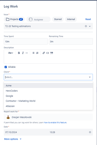

If you are looking for a time tracking report that would allow you to show the time logged individually for each issue type, you can check our app - Clockwork Pro, or Free.
It allows you to break down timesheet data with different issue types, please see a timesheet example:
You can also create custom attributes to tag each worklog with your client name, and also filter it through the timesheet.
We can join together on a call and review your use case if needed.

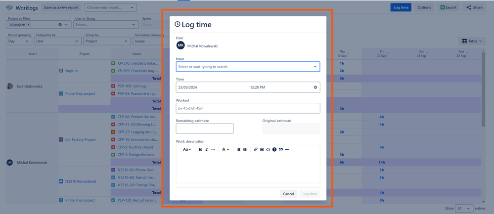

This is Michał from SolDevelo company and I'd like to show you an app that our team developed for creating reports for Jira time logs.
The report can show you all projects, users, logged time, original estimates, different sprints etc.. There are many possibilities how you can filter the report and what’s the best is that we constantly improve our app. This is an example from the app:
The app is called “Worklogs - Time Tracking and Reports”, it’s very easy to use. and currently it's a bestseller in the Atlassian marketplace when it comes to the time tracking apps.
I encourage you to try our app because you don't pay anything for the first 30 days anyway.
We are also happy to answer any questions about our application. Feel free to contact via portal here, or if you prefer a meeting you can book a demo session with us here.

We are very happy that you appreciate our tool! When it comes to your questions regarding the timer, kindly be informed that we do not have such an option in the app.
In our application, the time is always logged manually by the user via a modal that you can see below on the screenshot:
Perhaps the timers you mention belong to another application that you also use on your Jira instance? It is not excluded that both applications can run simultaneously at the same time.
Let me know if you have any additional questions. If you prefer you can also contact us via customer portal. Always hapy to help!

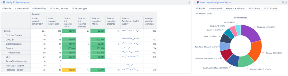

Hi, correct me if my interpretation of your situation is wrong but my impression is that you may benefit from creating or utilizing a team field, and service field as well as utilizing the built in response and resolution SLAs capabilities. You can track the SLA performance based on a team or service field as well as building different queues to keep them separately managed.
The fields I mentioned help us drive reporting by team and service
K.
July 9, 2024
Hi Christopher,
thanks the response. SLA reporting is not so much the issue in this instance. It's more an hours spent issue.
e.g. imagine one of the workstreams is a T&M engagement, where you're required to report on hours spent.
