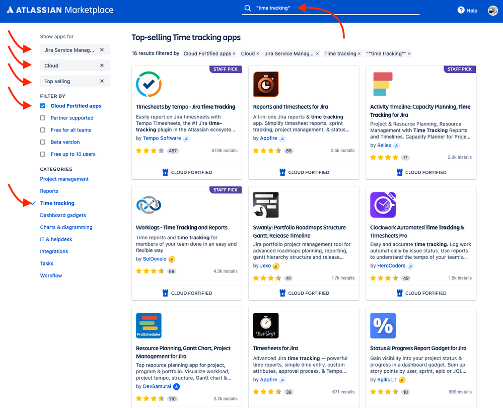

Hi, @Elif Alverson. To add just a little to what @Rudy Holtkamp has already suggested, this search will show you all of the time tracking add-ons that work with JSM/cloud.
Apologies in advance if this is something you already know how to do and you were looking more for actual user recommendations.
You can/should tweak the search criteria I used to suit your needs.

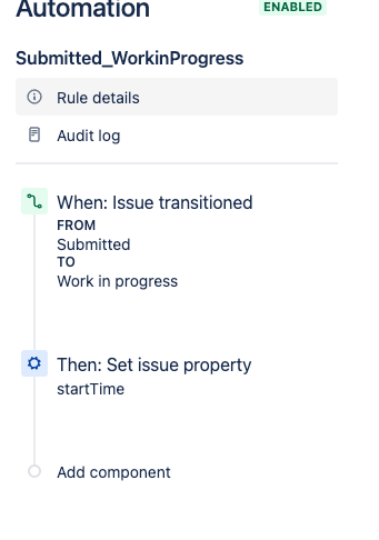

So here are the steps:
  1. go to your project > Project settings > automation > Create rule
  2. Add the 'Issue transitioned' trigger & select a from and to status
  3. Now you should have a place were you can keep the time you want to capture. I advice you to use Jira issue properties. One for start time, one for total time spent.
    Create an action of type 'set entity property'
    property key: startTime
    property value: {{now}}
    See for smart time based values: https://support.atlassian.com/cloud-automation/docs/jira-smart-values-date-and-time/
  4. Save the rule

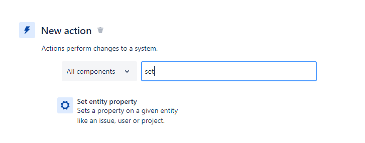

@Rudy Holtkamp , I am at the issue actions section and not sure which one to pick to create an action of type 'set entity property'. Do you mean to create a new custom field called "set entity property"? and pick the "Edit Issue"? Please see below. Thank you.
Screenshot 2023-01-10 at 11.05.19 AM.pngScreenshot 2023-01-10 at 11.05.35 AM.png
Rudy Holtkamp
January 10, 2023
It's called Set entity property, you can search for it by typing 'set'.

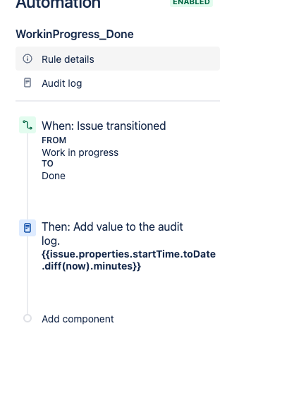

Elif Alverson
January 10, 2023
@Rudy Holtkamp , this automation works. Thank you so much!

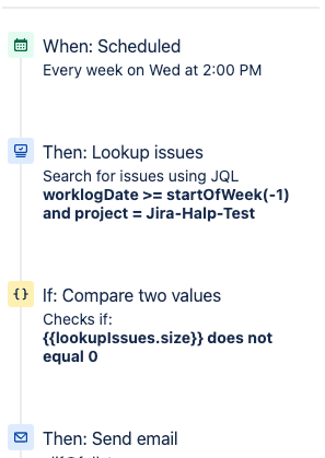

Hi @Elif Alverson ,
You can create another automation rule, with:
Trigger: Scheduled, run rule every 1 week on e.g. Monday
Action: Lookup issues, with JQL: worklogDate >= startOfWeek(-1) and project = <YOUR PROJECT KEY>
Advanced compare condition:
{{lookupIssues.size}} does not equal 0
Action: You can Send a Slack message, Twilio notification, Microsoft Teams message (as long as you have integrated them. For now use the action Send email.
Add recipients for the email.
Add a subject: These worklogs were created last week (or whatever serves your needs)
Add the body:
<b><u>List of issues:</u></b>
<ul>
{{#lookupIssues}}
<li><a href="{{url}}">{{key}} </a> | {{#=}} {{fields.timespent}}/60 {{/}}m | {{status.name}}</li>
</ul>
 This should do the trick.
You might need to change the minutes for the time spent to hours, but you can figure that one out, I guess.

I set the automation as you recommended above and created a couple of test ticket test it. Unfortunately I have not received any emails even though audit says success no emails received.  Any idea why it does not send emails? Thank you!
Screenshot 2023-01-11 at 2.37.12 PM.pngScreenshot 2023-01-11 at 2.39.56 PM.pngScreenshot 2023-01-11 at 2.40.24 PM.pngIved an eScreenshot 2023-01-11 at 2.40.36 PM.png
Rudy Holtkamp
January 12, 2023
Hi @Elif Alverson ,
In the rule WorkInProgress_Done you only have an audit (~debug) log.
You should add an action to log work.
Next to that, the Send email rule, will only send an email when it finds worklogs created last week. This is the -1 in startOfWeek. For testing things you can remove the -1, which leaves startOfWeek(), this will give you all the worklogs from the beginning of this week until today.
Like Elif Alverson likes this
