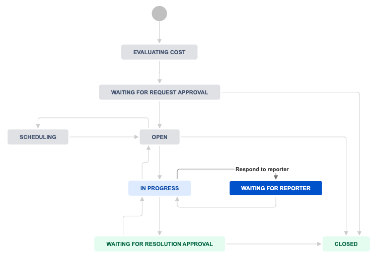

I have a workflow where issues can transit from status "In progress" to "Waiting for reporter" via the transition "Respond to reporter":

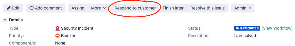

However, in the agent view this transition is shown with button "Respond to customer":
Why is that?
What's weird is that this is the only exception: all other transitions are correctly named in the corresponding agent view's buttons.

Hello Marco,
>> Are you sure that the workflow you show belongs to issue type Security Incident?
Yes, I have only 1 workflow, and it serves Security Incident too.
>> The transition "finish later" which one is that? To what status?
Finish later goes from "In Progress" to "Open". It is not affected by the problem.
>> And if it is the right workflow, is there a property set up in the transition "respond to reporter"?
Yes, there are 3 properties and I think you spotted the problem!
jira.i18n.title=sd.workflow.itsupport.v2.transition.respond.to.customer.title
jira.i18n.submit=sd.workflow.itsupport.v2.transition.respond.to.customer.submit
opsbar-sequence=5
The problem is probably due to the first one, which forces the title to "Respond to customer". Do you think I can just remove it with no consequences?

Hi @Davide Gallina ,
As far as I know you can remove it, it's purely a cosmetic thing.

Marco,
Problem is gone.
Thank you for your help, very much appreciated!
