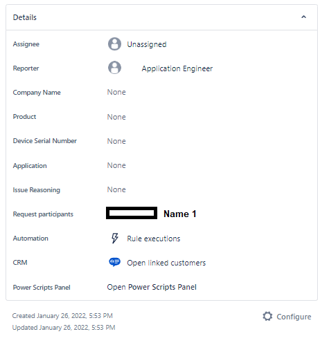

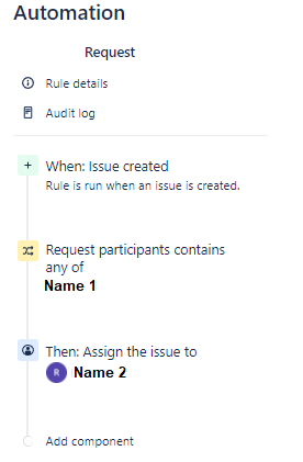

I need to assign the issue to a particular assignee when the issue is created and the "Request participants" field contains a specific email address.
I use simple
Then I test by sending the email request with "Name 1" in CC, the issue is created, the "Name 1" is in Request Participants:
but the Audit log reports that "The following issues did not match the condition:" and the rule is not applied.
It seems pretty straightforward, so I don't understand what can be the issue here. I tried using the Advanced rule with accountID, etc, and the result is the same.

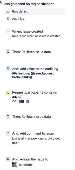

so i did some testing using the below automation. Initially w/o the refetch actions.
Test 1: without the refetch the Assign wasn't happening because the Condition failed as @Alla Austin mentions. Note - looking at the test issue the RP did have the Cc user as well.
Test 2: Based on T1, I theorized that for some reason the RP field was not getting populated at create time before automation triggered. So, without refetch I changed the trigger to be on a Comment. The test was successful and issue assigned as expected.
Test 3: I decided to use the re-fetch data to see if it would address the apparent race-condition. As shown in my automation I added two re-fetch actions, though this is over-kill. The test was successful.
Summary: for some reason the RP data is not added before the automation triggers. I hope to learn why.

Thank you so much! I did re-fetch (right after the trigger "case created"), and it worked. Last night I had a suspicion that for some reason, the PR field was populated after the case was created (even though it makes no sense), but I was so irritated it did not work that I gave up and created a cry for help on here :)
Thank you, @Jack Brickey and @Pramodh M, for responding so fast! I am not an experienced user of Automation and did not know about the re-fetch function. My rule works now. @Jack Brickey thank you for going the extra mile!
