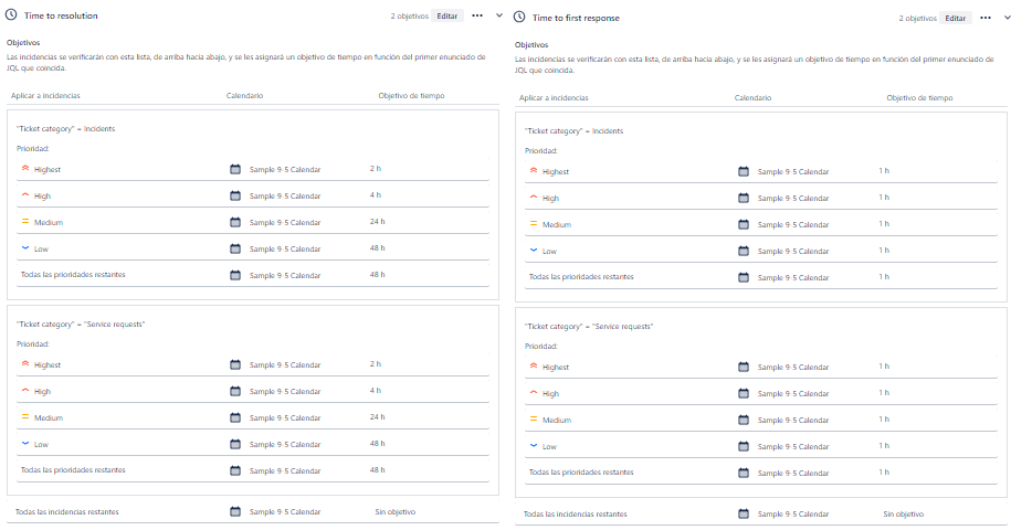

The SLA is not working. I have already configured it, but the time to first response and time to resolution are not showing up in the queue. SLA.png

What does your SLA looks like? Are you filtering based on issue types of request types? If you use the same query in a filter will it include the request  that you are expecting the SLAs to pick up? What status is the request in?

I copy the queue board with the tickets, one in progress and one to be done, as well as the SLA configuration....image.pngimage.png

The only thing missing from your screenshots of the SLAs are the start and stop conditions, but as @Gizem Gökçe _OBSS_ mentioned above SLAs do not go back in time to start the SLAs for an issue.
Did you set up these SLAs after the requests included in your screen shots were created? Or was the SLAs already there before? If they were created before the requests, what priorities are on the requests? If so, what does the conditions look like for your SLAs?
