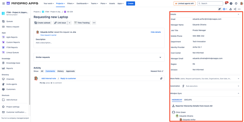

You need Atlassian Guard for this purpose. However, it only provides access to a few attributes. You can get them via API; however, there are limitations to what you can do with them. If you are open to a marketplace solution, I recommend Mindpro Sync (I work at Mindpro). The app lets you sync all the main attributes from Azure AD (including extension attributes) and map them to Jira read-only custom fields. This means you can use these fields not only in automation but also in JQL within Jira.
The app also allows you to display these attributes inside issue screens and provides a way to display the hierarchy, groups, and set approvers using the manager information.
Since you can bring the data and store it in custom fields, the attributes can be used in JQL, dashboards, or any reporting apps that read custom fields.
