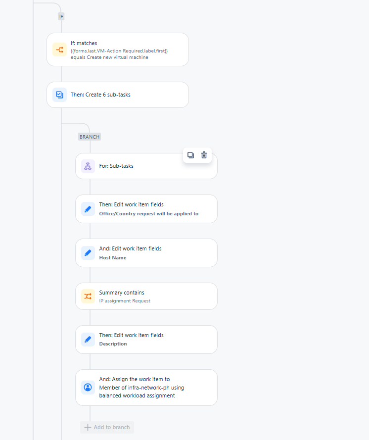

Hi,
Not sure if this will come off as confusing, but I created an automation that upon ticket creation 6 sub-tasks will be created, the requester requires that the 5 sub-tasks will not be able to change status until the first sub-task requirement is provided, (or at least what I'm thinking is once the status of the first sub-task has been set to DONE)
Is it possible to block the status transition of the 5 sub-tasks?

 Hi  @John Funk
I have done the following steps
1. added a custom field
2. added a pre-set value of "FALSE" in the custom field created.
3. The first sub-task has no Value set for the custom field
4. Added condition to the workflow that the status should only be allowed to transition if the value of the custom field is NULL
(The trigger to set the custom field of the other sub-tasks to NULL would be the status of the first sub-task when it is transitioned to DONE)
Should I create a new automation that would trigger the custom field to update to NULL, or can I just add it to my existing automation?
Should I create a new FOR EACH branch or should I add it under per sub-task rule?

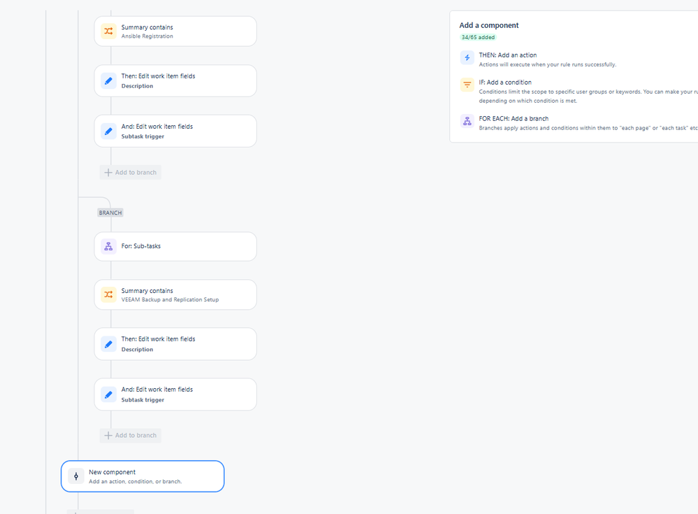

Hi @John Funk
Thank you for answering, i tried creating the new rule, the question is how I identify the sibling subtasks of the first subtask from the new rule. I tried using the Link issue but i can't use issue key of the sibling subtasks, since it will dynamically change and it's a new rule.
