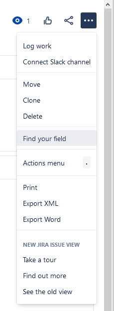

one additional idea for diagnosis would be to open an existing issue (sub-task) in the project you are working on.
Then go to (...) on the right >> "Find your field"

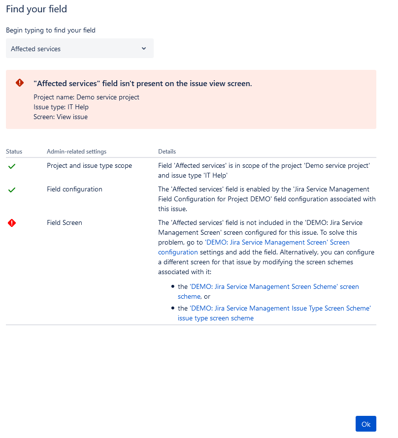

It should look like this:
The screen appearing then should give a clue why the field is missing for you.
Please see an example from my instance above.

Brijesh Pathak
August 8, 2021
Thanks Daniel.. this was added using the same steps earlier but after adding I was not checking under "more fileds" section.. that's where it was :-)

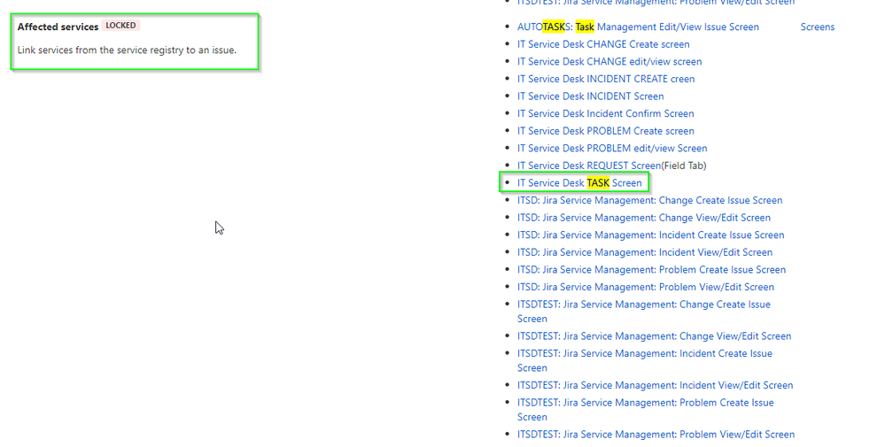

I have verified that "Sub-Task" issue type is associated with "IT Service Desk Task Screen Scheme" screen and when I go to "field configuration" found that field "Affected services"  has sceen ""IT Service Desk Task Screen Scheme" associated.

Just because the field is associated to the screen, the field itself still needs to be available for the issue type in field configuration setup.
