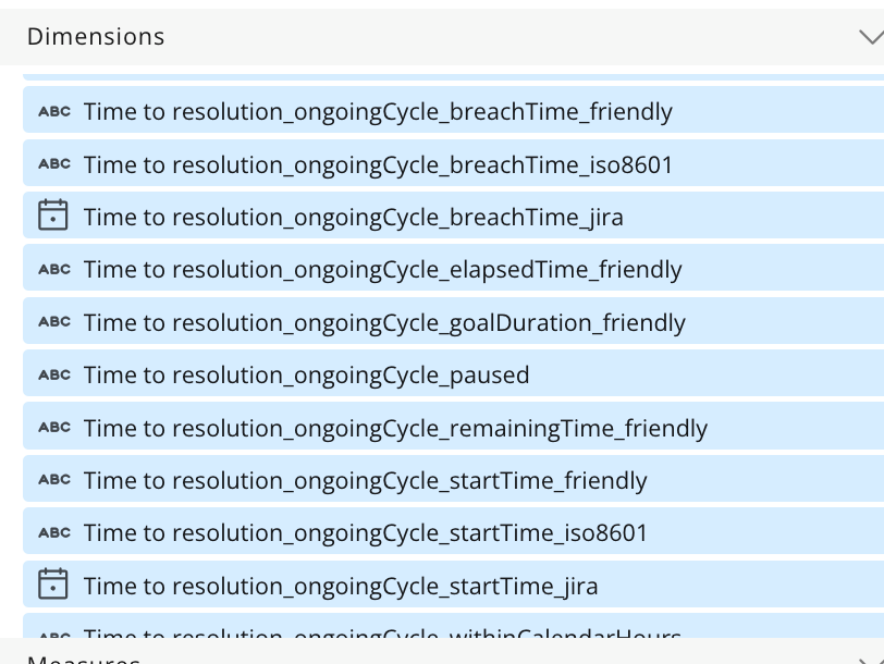

In a BI tool I am struggling to calculate my mean time to resolution as I am unable to find the relevant fields/measures to do so.  If it was simply created time and resolved time it would not be a problem but I need to factor in the SLA pauses too.
Has anybody else been able to do this please?  There are many time to resolution fields/metrics behind the JSM scenes but none of them seem to give me the actual time it took for resolved incidents - all the fields are for on-going only
Attached just some of the examples

Hi @Kevin Rowe,
You can calculate mean time to resolution in eazyBI using the built-in SLA measures:
  • SLA Elapsed hours - shows the total amount of elapsed hours for all completed SLA cycles. This measure is assigned to the Time dimension period when the SLA cycle was completed.
  • SLA Completed cycles issues count - shows the unique count of issues with completed cycles, assigned to the Time period when the cycle completed.
To get the average resolution time, you can divide these measures:
[Measures].[SLA Elapsed hours] / [Measures].[SLA Completed cycles issues count]
Note that these measures work with completed SLA cycles and take into account any pause conditions defined in your Jira Service Management SLA configuration.

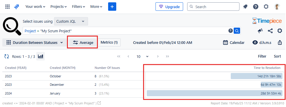

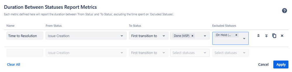

Are you looking for a way to calculate this directly in your BI tool, or would you consider using a ready-to-go report with a third-party app like Timepiece - Time in Status for Jira?
Timepiece, which is built by my team at OBSS, provides a Duration Between Statuses report that lets you calculate the resolution time while excluding SLA pause statuses. You can define which statuses should be counted and which should be excluded, ensuring an accurate Mean Time to Resolution (MTTR). The app also integrates with BI tools like Power BI and eazyBI, so you can use the calculated data within your existing reporting setup.
For all numeric report types, you can calculate averages and sums of those durations grouped by the issue fields you select. For example, in the screenshots below, the Duration Between Status report shows the Mean/Average Time to Resolution grouped by issues created each month. DBS Metrics.png
The app calculates its reports using already existing Jira issue histories so when you install the app, you don't need to add anything to your issue workflows and you can get reports on your past issues as well. Reports are available via the reporting page, dashboard gadgets, and issue view screen tabs, with both data tables and charts. Timepiece also offers a REST API for seamless integration and supports CSV/XLS exports.
