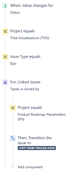

I have setup an automation rule to transition issues linked with "cloned by", when the linked issue is transitioned, as follows:
When the rule runs, I receive the error:
Transition issue
Destination status could not be resolved.

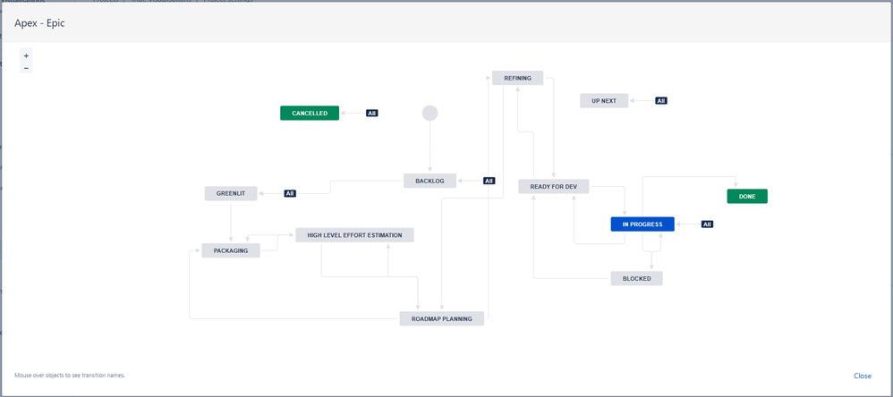

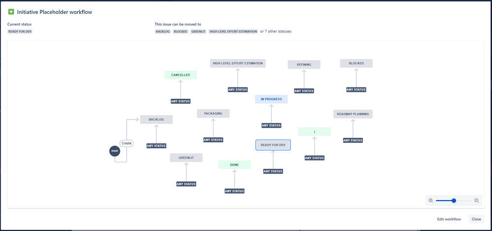

Thanks for the quick feedback. The workflows are different, but statuses are replicated in both. And transitions, even if not identical, are present in both workflows, as follows:
Epic workflow:
Product Roadmap Placeholders workflow:

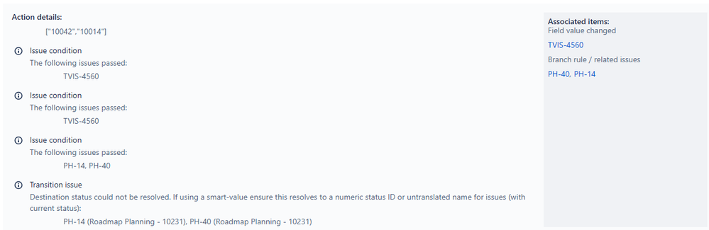

Expected to transition as well to Refining. Following the Automation error log:

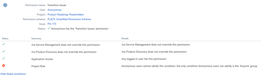

Check the PH project Permission Scheme to see if the atlassian-addons user has the permission for Transition Issue.
Samuel Tabbo
July 3, 2023
Thanks @John Funk . This is the outcome of the permission helper query. I didn't manage to query with the specific atlassian-addons user, as the System Permission Helper doesn't allow these type of users.
Is there another way to verify this?

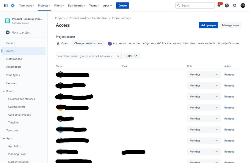

Okay, understood. Did you check the Transition Issues permission to be sure the
  • Project Role (atlassian-addons-project-access)
is there?
Samuel Tabbo
July 3, 2023
Thanks @John Funk . I checked in the Access configuration of the Project, and the role atlassian-addons-project-access is not present in the list, and it is not possible to add from the search function.
John Funk
July 3, 2023
Okay - is there an entry in the Permission Scheme for that user/role? And if not, can you try to add it as a Group instead of a Project Role?

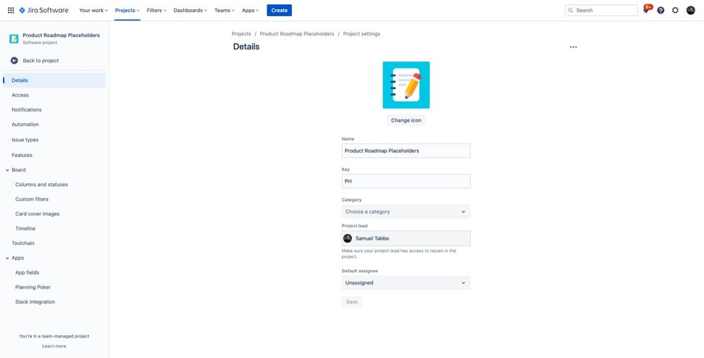

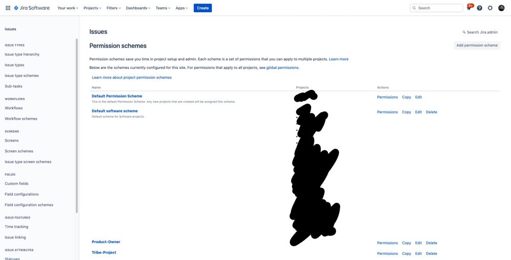

Samuel Tabbo
July 6, 2023
Apologies @John Funk , but this is a bit too advanced for my knowledge of JIRA. I explored the Permission Scheme page, but I didn't find the Product Roadmap Placeholders project associated with a Permission Scheme, nor did I manage to associate it to one of existing Permission Schemes.
Like John Funk likes this
John Funk
July 7, 2023
Okay, no worries. Let's start with the project. Go to the project and then click the Project Settings at the bottom left of the page. You must be a project administrator to be able to see that link.
Once on the next page, click the Summary link in the top left. On the next page you will see all of the schemes used by the project. Click on the Permission Scheme there and take a look.
Samuel Tabbo
July 7, 2023
Thanks @John Funk . I tried to do as you suggested. Unfortunately, there is no Summary link nor Schemes page for this Project.
John Funk
July 8, 2023
Ah, that means you are using a Team-managed project.
You either need to change the Actor for the Rule (I think that is what I would do) to say the user who triggered the event, or another user such as the project administrator (you would need to know his/her name).
Or you need to add the atlassian-addon user or group to the Access for the project.

John Funk
July 15, 2023
Can you share a screenshot of the transition details from the workflow?
