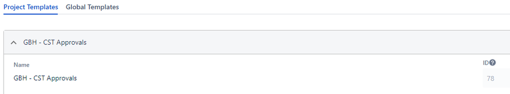

I recently discovered Smart Checklists for our Issues in JSM.  So I created one and found I can save it as a Template and then import it to any issue at will.  Then I wondered if it was possible to have the Checklists imported to the issue via a Rule Automation.  Yes, I know the Manage Templates screen (where I found my checklist has an ID of 78) shows a level of Automation wherein I can have the checklist show up by default for ALL of the Issues...but I don't want that.  The checklist should appear in the issue only if the issue meets certain criteria.

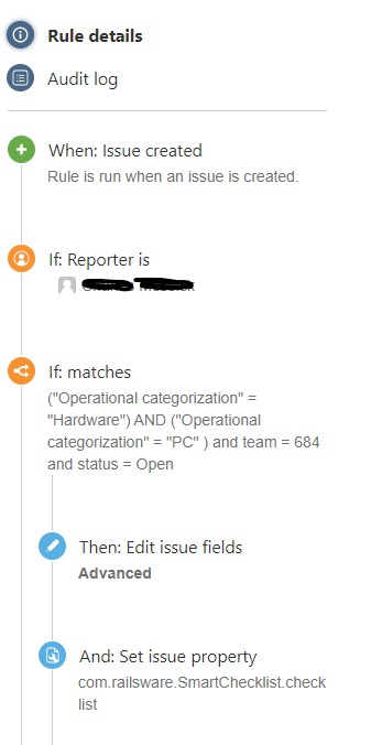

When the Issue is Created...
If the Reporter is me...
If ... and I have a Match Condition
Then ... I edit one field to change the value

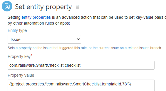

AND ... Set Entity Property
....wherein the Key Property is com.railsware.SmartChecklist.checklist
and the Property Value is
{{project.properties."com.railsware.SmartChecklist.templateId.78"}}

The rule runs successfully.  It does everything it's supposed to except the very last part even though the Audit Log reports success.  The checklist is not showing up.

The template is clearly a Project Template.

And the log shows :
Action details:
User condition
The following issues passed:
TICKETS-7091
If block
TICKETS-7091
Edit issue
Issues edited successfully
TICKETS-7091
Set entity property
Successfully set entity property.
