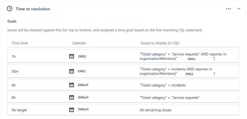

I'm in the process of setting up SLA's in our cloud based Jira SM. We've got some clients with differing SLA's from the norm.
In my tests with a calendar I named "testorg" above pictured setup worked fine and the resolution SLA updated automatically as it should, but there's something in this that breaks things. Granted, that test SLA goal was only for requests, not incidents.
Can you have two different SLA goals that have the same "reported in organizationMembers" organization name but different ticket types (incident and service requests)?

Juuso Ikonen
May 25, 2021
Thank you, though I have might have left out a pretty big reason why the string is
>"Ticket category" = Incidents AND reporter in organizationMembers("ORG1")
We have different SLA's depending on the ticket category.
These are the categories I meant. The request type and issuetype would probably be too specific for our use, unfortunately.
I'm pretty sure the SLA's now work correctly, though, so I'll mark this as solved. Thank you!
