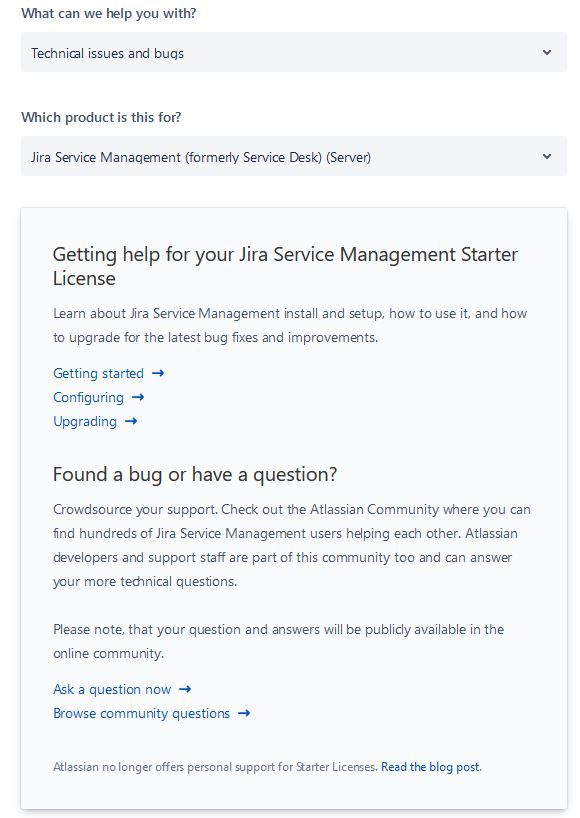

Georgios Dimitrakakis
December 5, 2020
Hi!
Thanks for the feedback...I have already tried that but it seems that I am stack here :-(
I have a starter license hence I am not entitled to Atlassian support :-(Atlassian.JPG
December 7, 2020
I did manage to contact Atlassian but my request went to billing and licensing team.... this is where my request ended since it seems that there is no way to properly report a bug if you are on a starter license! Ridiculous ....
Anyway the feedback I got was the following: “...This is out of my scope of support and to better assist and answer your queries regarding your technical issues, you would need to seek assistance from Community Support where we have Atlassian partners, experts, and champions to assist you.
As Community Support is the only channel available for our Free and Starter license users, we make sure to pay special attention to getting to these requests. ...”.
Hence I have no other option but to wait....so fingers crossed that until then all will continue to function without having a problem.
