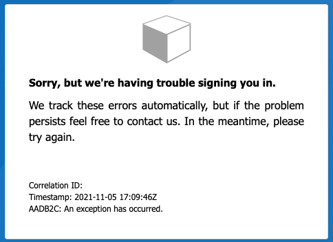

I see that the email is being redirected to that page and it shows an error that points to Azure AD B2C and it seems to be a configuration problem on their side:
I found this documentation that might help, but I would like to share that when setting up SAML with Azure, the documentation that contains the steps is the one below:
The documentation you are following is not from a native integration. The one above is one where Atlassian worked with Azure to have a specific template.
Please, take your time to go through that documentation and let us know if you have any other questions.
