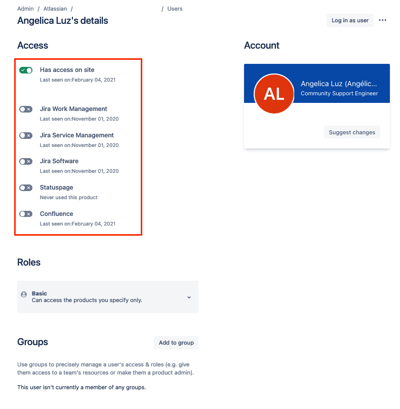

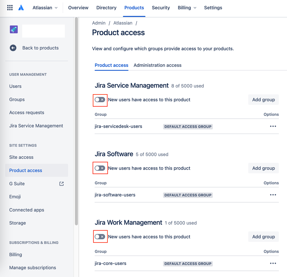

Go to Cog icon > User management > Product access and disable all of them. Note that, it won’t affect any user. This will only prevent that, when migrating the customer, they won’t count towards a license.

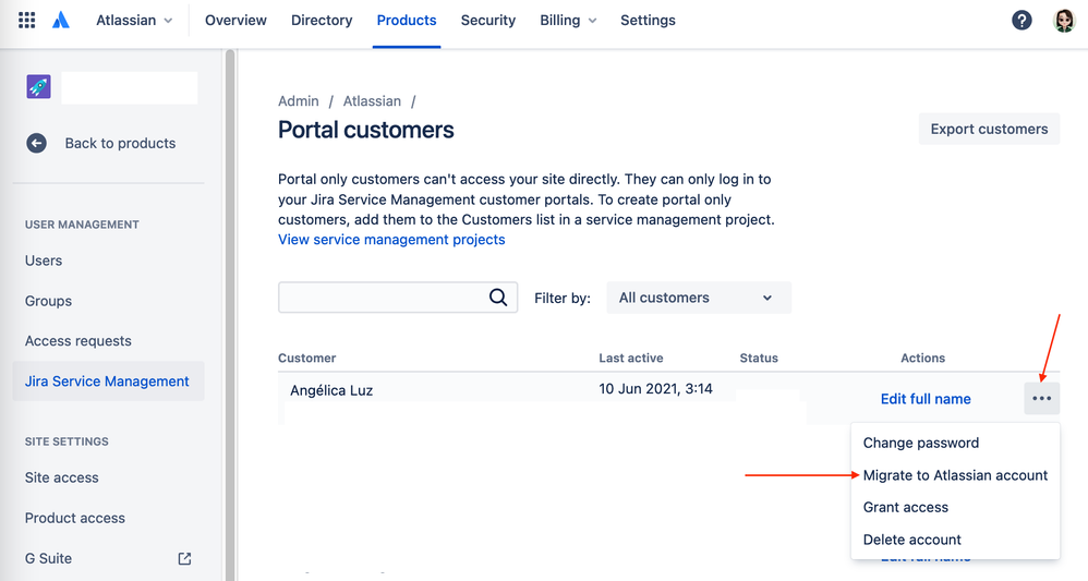

After that, from the same Administration page, click on Jira Service Management where the customer will be listed. Then, migrate the account to Atlassian account.
Once this is done, the customer will be listed as an internal user, but since they don’t have applicate access (since it was disabled on Product access), they will only be able to access the portal.
