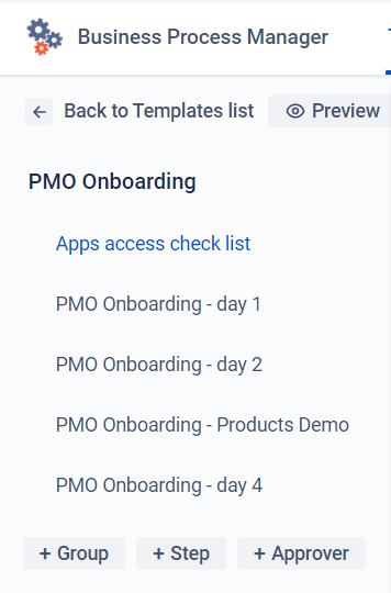

To approve specific tickets you can use Approver step in Business Process Manager add-on developed by my team
So, you can streamline any processes that are accepted by another person. Add individual users or groups of users to approve requests in sequential order.
When the assignee submits a form in issue, all selected Users will see Approve & Reject buttons at the Form. When a person makes a choice to Approve/Reject, the system will add a comment to the issue.

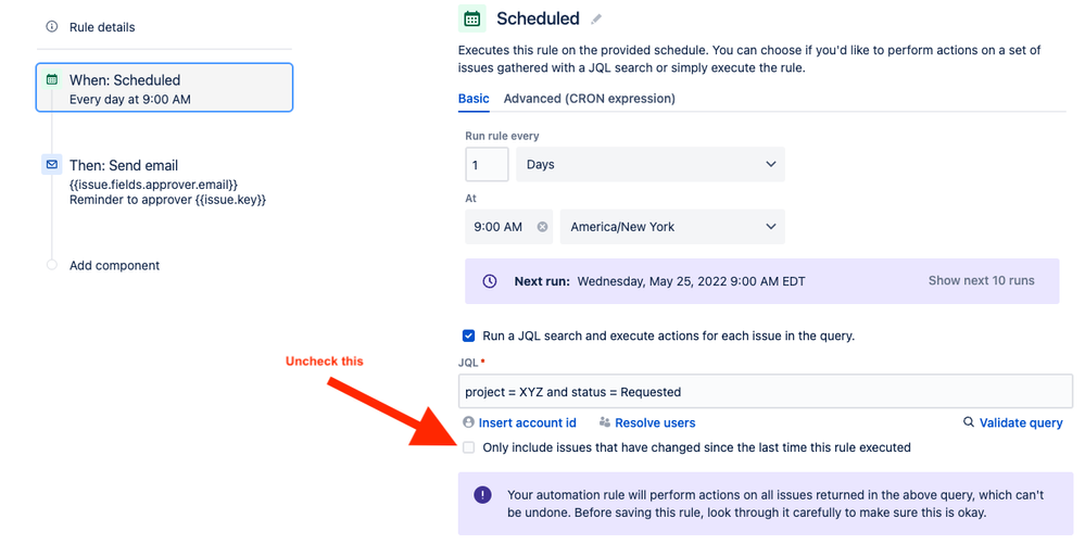

Then the JQL could be something like:
project = XYZ and status = Requested
Does that help?

Garrett McCreery
May 24, 2022
No, you should not have to. The schedule trigger will run each time for what it finds in the JQL. Once you are getting the issues that are in status - "Requested" you should be able to use a smart value like "Issue.fields.approver.email" or something similar to pull the email and then whatever you want to say in the body of the email.

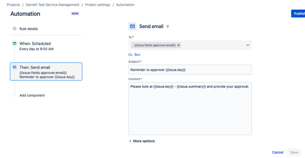

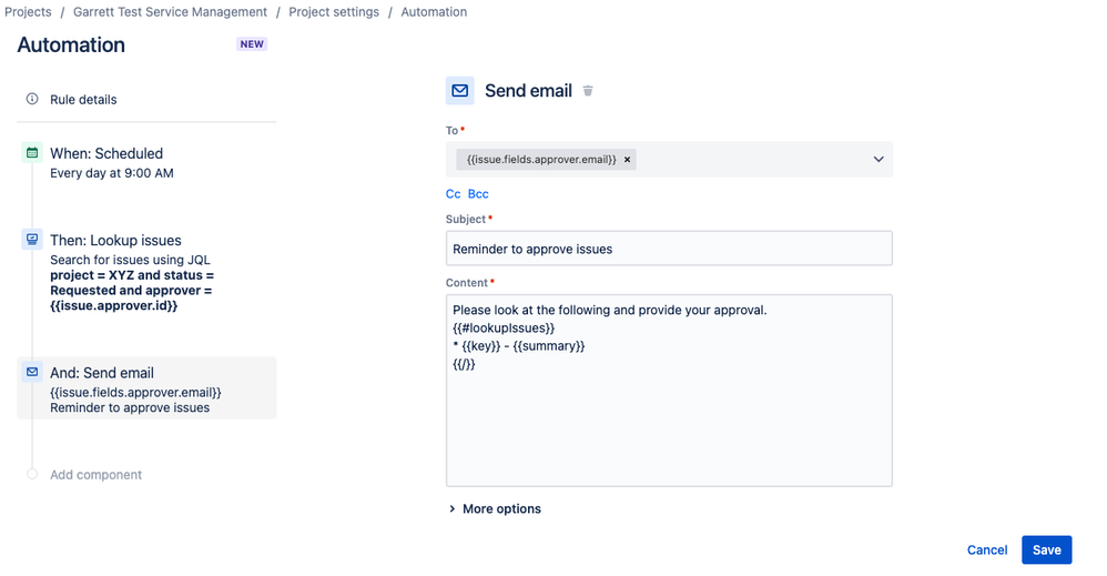

Here are some screen shots... I don't know if the smart value for the email is correct, but this is the gist of the solution:
Garrett McCreery
May 24, 2022
I am assuming that your approver field is a user field type. if so the email address smart value should be:
{{issue.approver.emailAddress}}

Here is a screenshot:
Garrett McCreery
May 24, 2022
WAIT.... My mistake, that will still send as many emails as there are issues... I'd have to think on this more...

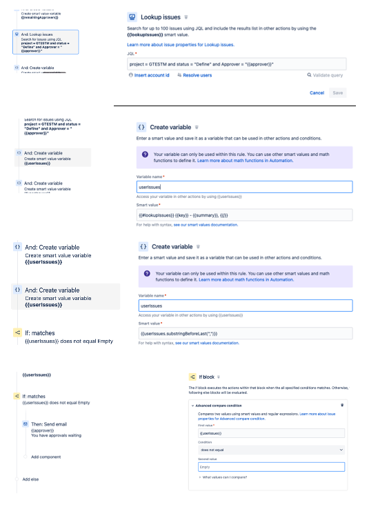

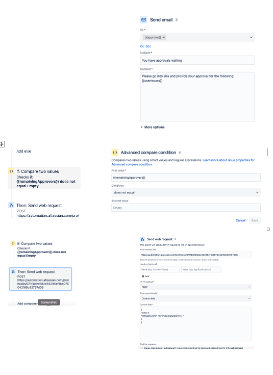

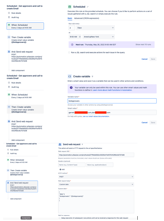

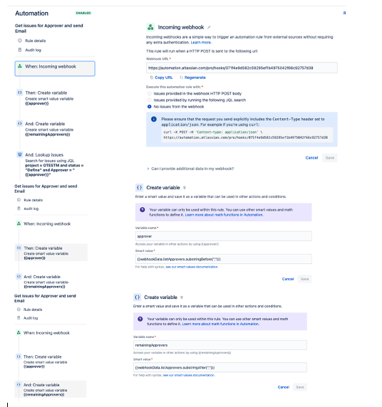

Garrett McCreery
May 24, 2022
ok, this works... It's a little bit of work, but I hope the documentation makes sense...
This will require 2 automation rules, with the first one calling the second, and the second one calling itself (until there are no more approvers).
Automation 1:
Step1: Scheduled (no JQL) trigger
Step 2: Create a variable with list of approver emails separated by commas
Step 3: Send a web request passing the listApprovers. The URL used here is generated when we create an incoming webhook automation (the 2nd Automation). The custom data should remain as shown.
Automation 2:
Step 1: Incoming Webhook trigger
You will notice that the URL here is what is being used in the prior automation step. Be sure to select No issues from the webhook.
Step 2: Create variable getting the 1st approver
Step 3: Create variable taking out the 1st approver from the list (has remaining approvers)
Step 4: Lookup Issues using the approver in the JQL
Step 5: Create a variable with key and summary of lookupissues
Step 6: Create Variable (Update that variable to remove the last comma)
Step 7 and 8: Make sure there are issues before sending the email (IF ELSE and Send Email, nothing goes in the else part
Step 9: See if there are any remaining approvers
Step 10: Send Web Request (Calling the same automation, passing the remaining approvers minus the one that we removed). This will continue to call until there are no more approvers.
