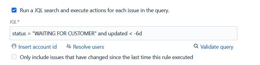

I have set up an automation rule to prompt a user for comment when a helpdesk ticket is in the status of 'Waiting for Customer' and has not been updated for a week. The rule setting is like this and it is checked once a day

I cannot get this use case to work.  I tried changing the filter so it only looked for issues between 6 and seven days since the last update and removing the check box to prevent duplicates by only sending once, but this did not solve the problem.   Does anyone know how I could solve the use case above using available automation in Jira Service Desk cloud?

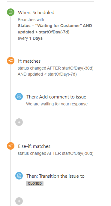

I'll share with you, how I made such escalation mechanism, maybe it will suit you.
I was struggling with this riddle too, and solved it with adding comments to requests. So, I am checking how long issue is in Waiting for Customer status, and checks updated date. If issue is for a month in this status, it's closed. And every 7 days I add comment to issue, like "Dear Customer, please respond…"
My rule looks like:

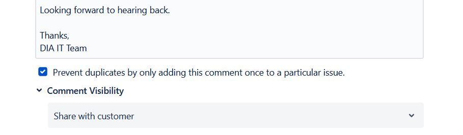

Hi Evgeny - in the example above, do you uncheck the box to only send once?
When I unchecked this box, the message kept sending every day.  I thought it would not do so because the comment sent the day before would count as an update.

Hi, @Alex Eldridge
In my rule this box is unchecked, to count, how many times user was notified.
And issue is commented every 7 days, it's set in JQL

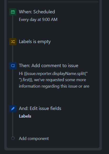

Hi Dan - the labels idea is interesting. I am wondering if I could set a rule to look for an empty label, if empty send the comment and add a label, then remove the label if the customer responds.  It seems complicated and I would like a simpler solution, but maybe this could work. What do you think?
