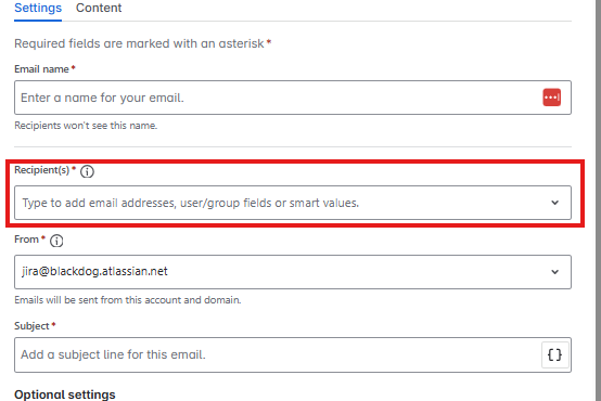

Hi all,
I'd like to send an email to the creator of an object when it has been created in Assets but am not sure what to add into the recipients field. How could I go about this?

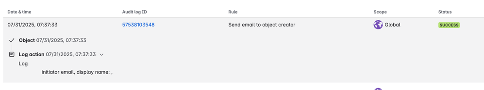

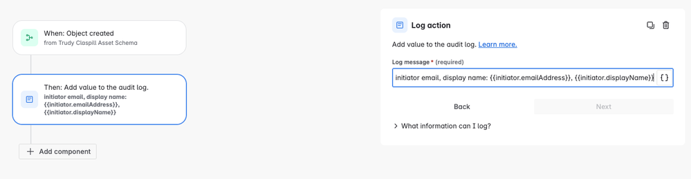

Not an answer but a confirmation of the results you are getting.
I created a rule with the Object Created trigger and a Log action to simply log information from the {{initiator}} smart value, using the information about that smart value available here. And I get no information from the {{initiator}} smart value.
Screenshot 2025-07-31 at 7.36.52 AM.pngScreenshot 2025-07-31 at 7.38.09 AM.png

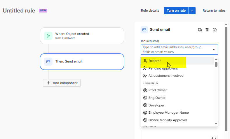

Hi @Trevor de Souza
I would try the send email action and then use the "Initiator" value from the dropdown

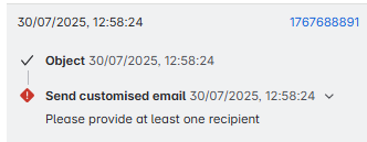

Trevor de Souza
July 29, 2025
When I try that I get the error message "Please provide at least one recipient"

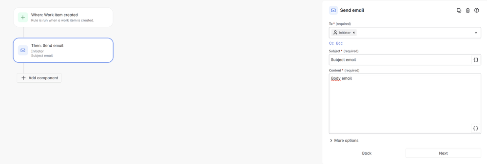

Pedro Olmo
July 29, 2025
Hello @Trevor de Souza .
Can you take a screenshot of the entire process of sending an updated email?
Regards

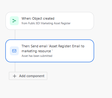

Trevor de Souza
July 29, 2025
Hi @Pedro Olmo ,
Just the below.
Pedro Olmo
July 30, 2025
Hello @Trevor de Souza ,
Attach rule action (send email)
Can you set up the rule like this?
Regards

Pedro Olmo
July 30, 2025
If the trigger, and in yout case the initiator, is the one who creates the object. This configuration that I am providing you with the action to send an email should work for you.
Your action must be to send an email. Perhaps you are using the new action to send a customized email.
Regards
Trevor de Souza
July 30, 2025
Hello @Pedro Olmo,
When I try with the "Send Email" action I receive the following

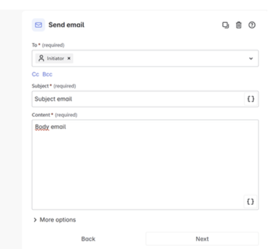

Pedro Olmo
July 31, 2025
Helllo @Trevor de Souza ,
Can you share screenshot action?
Regards
