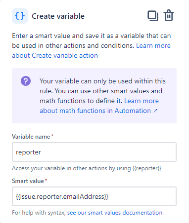

Using the Variable action, create a variable containing the Reporter's E-mail:
{{issue.reporter.emailAddress}}

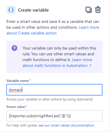

Create another variable that will store the Domain:
{{reporter.substringAfterLast("@")}}

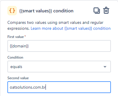

Create a Condition that compares the Domain variable with the specific Domain:

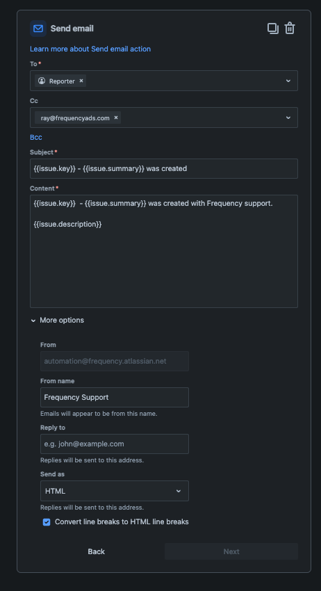

Use the Send E-mail action to send an E-mail to the reporter if necessary and in the "CC" copy add the specific E-mail:
It will look something similar to this:

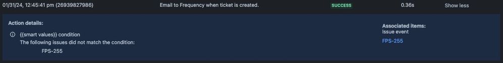

Thanks for the guidance Luiz.  For some reason I'm getting a success message in the Audit Log, but no email.  When I look in the Audit Log I get this message...
It appears to be coming from the Issue Created step.  Any help would be greatly appreciated.

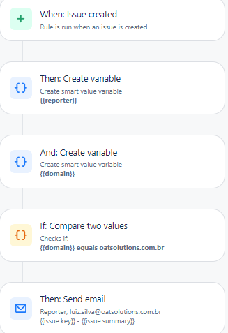

Luiz Ricardo Pereira da Silva
January 31, 2024
Hello @Ray
Could you post the automation structure so I can analyze it?
From what I can see in the image, success is linked to some action prior to the conditional, however the conditional was not accepted.
If the action of sending an email is after this conditional, it is probably because the issue does not meet the condition and the email was not sent.

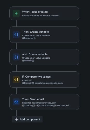

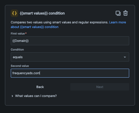

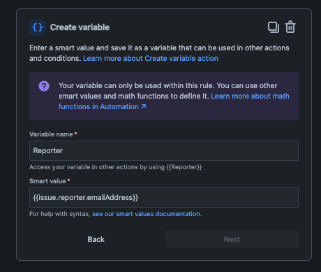

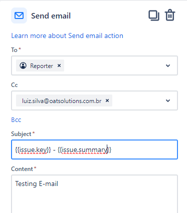

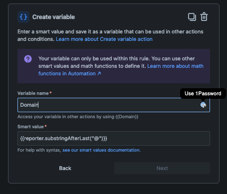

Ray
January 31, 2024
Ray
January 31, 2024
Here's more detail @Luiz Ricardo Pereira da Silva .  I am simply just trying to test this out.  So I am creating a new issue with my own account (ray@frequencyads.com).  Hoping that it will send the email to me as the reporter and as the cc.  As I said....just trying to test this out so I know it's working before I try it with a customer.
2024-01-31_13-38-40.png2024-01-31_13-38-52.png2024-01-31_13-39-04.png2024-01-31_13-39-19.png

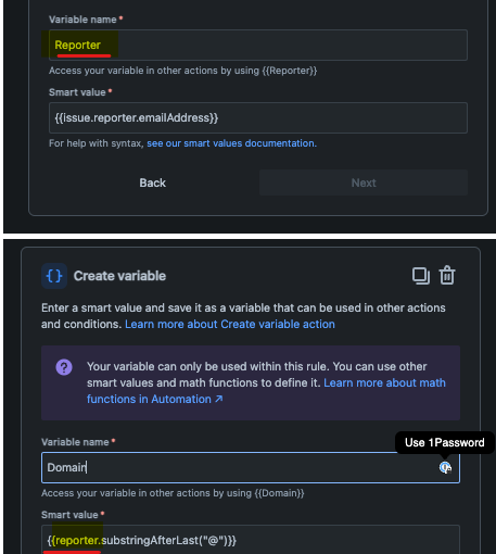

January 31, 2024
Enter the name of the variable Reporter for reporter, this capital R is affecting its recognition in the second Variable that retrieves the domain.:

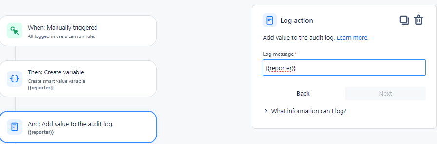

Also add an action called log action by inserting the name of the variable inside so that the result appears in the Execution log:
Create an Action log for each Variable.
This will help you with troubleshooting.
Ray
February 1, 2024
@Luiz Ricardo Pereira da Silva Thanks so much for your help.  This worked perfectly.  Thanks again!
