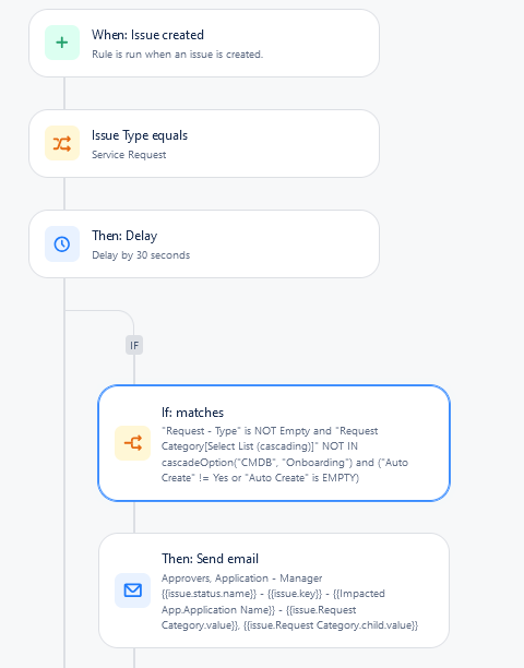

Rule Detail:

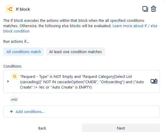

Detail view of If statement:

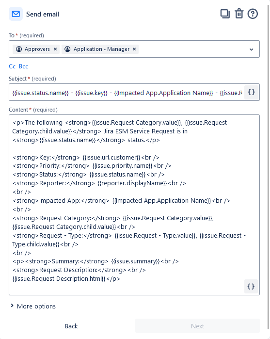

Detail view of Send Email block:

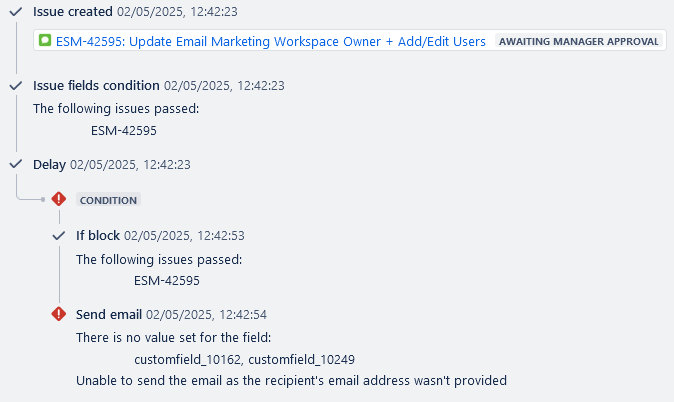

Audit log:

Instead of having this automation trigger on issue created, I would instead trigger on incoming webhook and then in the other automation that sets the two fields have that one send a web request to above automation.
Adding a delay to your automation does nothing, the automation only have access the data in the issue when the automation triggers. You would have to do a refresh of the issue in order to get any new values that are added after the automation triggered in order to pick those up.

Thank you. This was a critical piece of information that I was missing and it helps a lot knowing that. I wish Atlassian would add that to their documentation.
