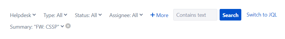

I would like to create a filter that is based off a text in the summary:
FW: CSSP

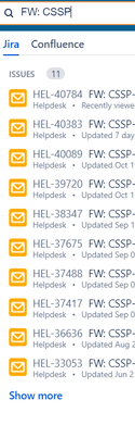

Here's the interesting part.  If i use the search bar in the upper right of the Jira window, and enter that search criteria, i get multiple results, with no problem:

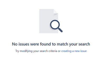

However, when i try to create a filter with the same exact criteria, i get nothing:
the JQL (for the above filter) is as follows
project = HEL AND summary ~ "FW: CSSP" ORDER BY created DESC
i cannot figure out why the filter will not work, yet the search bar has no problems

I copied and pasted your suggested JQL string.  No luck.  I removed "FW:" from the search and left just "CSSP", still no luck.  got the "No issues were found to match your search" message again.
if I use "FW:" I get hundreds of results.  for some reason "CSSP" seems to be the issue.
