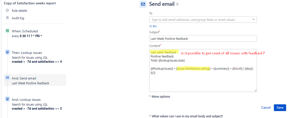

In my case, I wanted to get weeks reports, contains information like:
Last week feedback - 20 (how to get count, i am thinking its impossible?)
Positive feedback:
Total: 18
  • 5 - Test Summary - issue link - issue key
  • 4 - Test Summary2 - issue link - issue key
  • 5 - Test Summary3 - issue link - issue key
But whatever I try, it does not give a result in this format (rating of the satisfaction), the value above I tried in the very first attempt :)
Every times I get: • • test summary • issue link • issue  key
It seems that this field is not fully worked out, it seems to contain information, but it is impossible to get its value.
Regarding the comments, it looks like a similar situation. Creating a webhook is a pretty workaround))

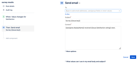

I tested the {{issue.Satisfaction.rating}} and it works on a simple automation.
Testing the {{#lookupIssues}}, it also didn't return the ratings on the notification, but it's expected because it's not supported for Lookup issues action.
