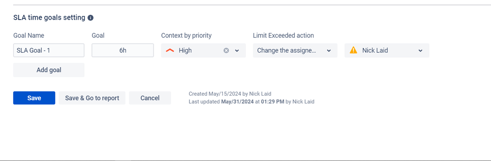

Hi @Karim Mohamed
I can propose you our addon SLA Time and Report for Jira.
You can configure the SLA to reassign the task to another person when it's overdue.
I hope I have understood your request correctly.

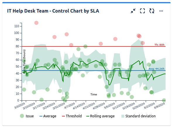

You can measure the SLA for each team/department by using the gadgets offered by our Great Gadgets app.
See this article: https://community.atlassian.com/t5/App-Central/An-effective-dashboard-for-Service-Desk-and-Customer-Support/ba-p/2360369

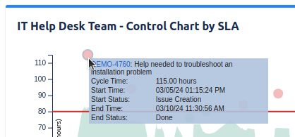

For example, with the Control Chart gadget you can display the issues for the last X months/days for a department or overall project. All you have to do is to configure a gadget with a filer/JQL that returns the issues of that department and to configure how to measure the cycle time (ex. from Issue Creation to Done, or from In Progress to Done - you decide, according to your SLA and workflow of each department).
The gadget will display the issues by their SLA on a timeline. It also displays the average and let's you set a threshold (your SLA value) to easily identify the issues that breached their SLA (the ones in red-color). Hovering the mouse cursor over an issue will give you details about it:
You can put 3 gadgets like this side-by-side, one for overall project, one for IT Help Desk and one for IT Dev Ops. This will help you see the average and the breaches at the global level, but also at the team/department level.
As you will see in the mentioned article, you could also use Histogram gadget and Cycle Time Trend gadget.
