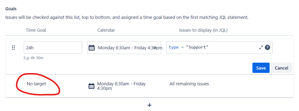

Hi @Manuel Rodrigues
If you remove the time goal from the 'All remaining Issues' section, then the SLA will only be present on the issues that fall within the JQL of the configured time goals above.
So it should look something like this:
