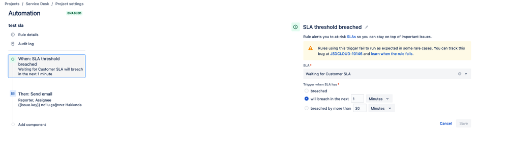

Hello to everyone,

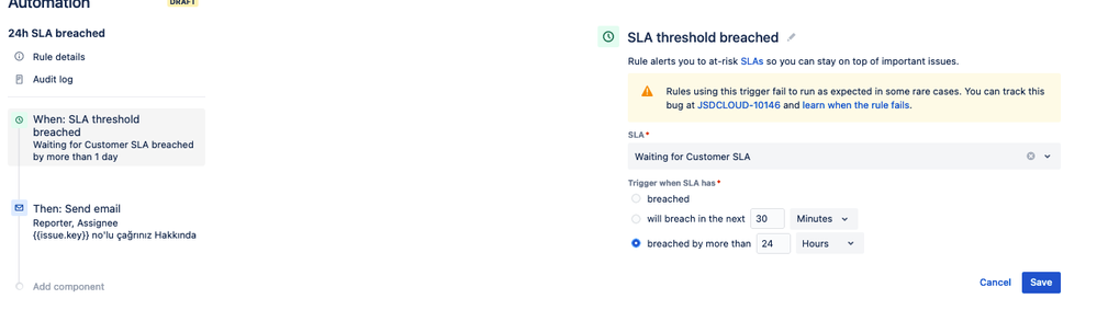

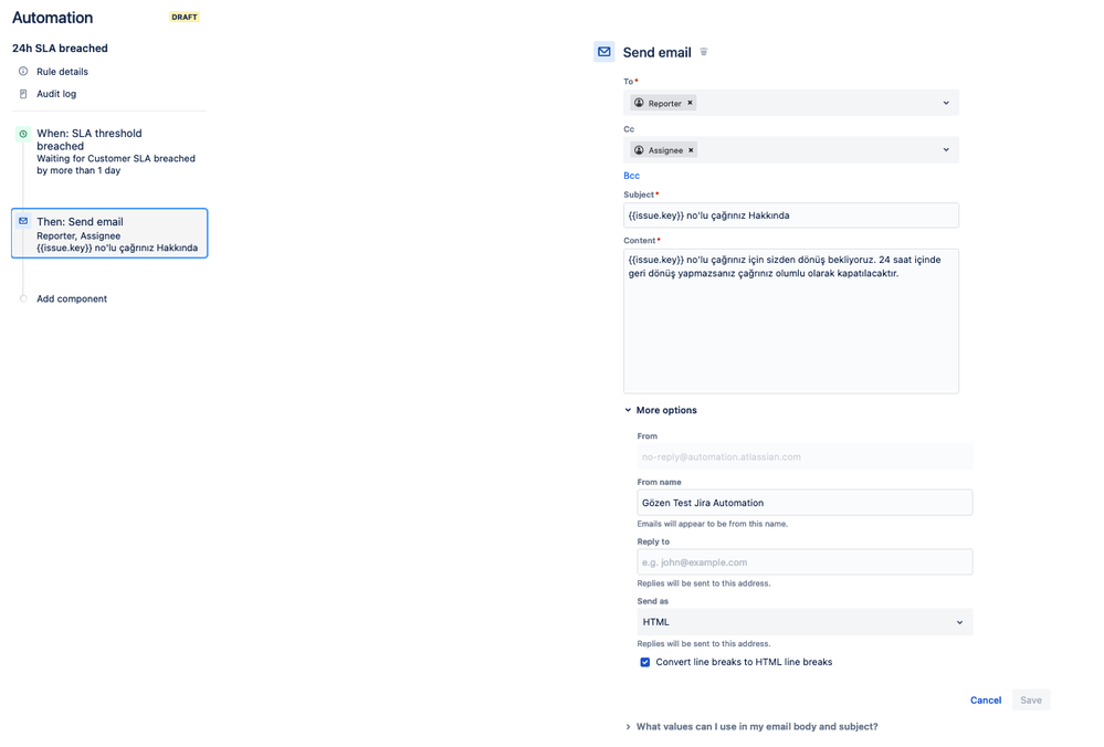

I want 48 hours to start when there is Waiting for Customer status.
I want to send an e-mail to "reporter" after 24 hours.
When the total is 48 hours, I want to close the call as resolved.
How can I do it with Automation?
I tried to do it, it didn't work..
Hi @Barış Özer,
If I understand your use case correctly, you are trying to send a email 24 hours before the SLA (of 48 hours) expires.
To do so, in the SLA threshold breached trigger select the second option: will breach in the next 24 hours.
Your current configuration will try to send the email 24 hours after the 48 hour target was passed. By then, you will already have closed the ticket and no email will be sent anymore.
Hope this helps!
Yes, you got it right.
There will be 48 Hours SLA period.
But after 24 hours, I want to send an e-mail.
I want the ticket to be resolved automatically after 48 hours in total.
I tried for 5 minutes for the test but it was not successful?
Can you send me a screenshot? I did as you said, it didn't work.
Hi @Barış Özer,
I am not sure how you can say it did't work after trying for 5 minutes. This trigger fires for tickets based on the SLA timer that is running. If a ticket reaches the 24 hour mark before the end of the SLA, it should activate the rule. If you don't have any tickets that match the exact trigger, nothing will happen.

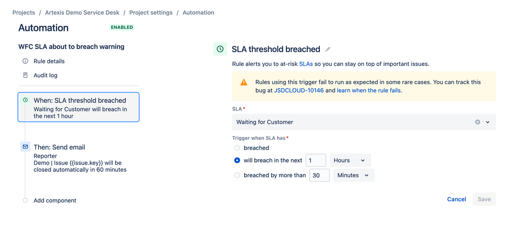

Hi @Barış Özer,
I am currently running a test myself on a test site. There's a number of things that should be in place here:
When testing, be patient to make sure that an issue actually does reach the point where the rule is triggered (that's why in my test scenario I used a shorter time frame so I can confirm if it works or not). Once more: do not expect this rule to work for issues that have been created e.g. 30 hours ago, as the trigger will not fire anymore for those.

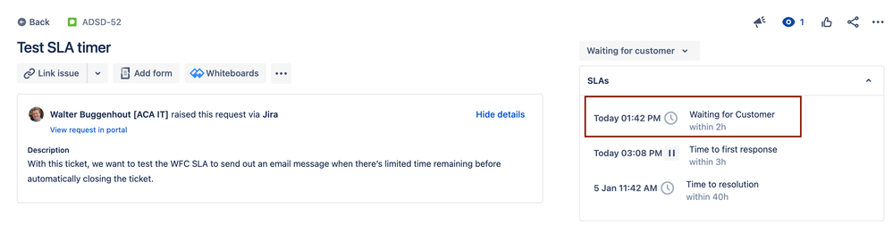

Also: check the SLA timer on your test issue(s). In my scenario, the following issue should send an email in 42 minutes (1 hour before the SLA is about to breach):
In your case, that should be 24 hours.

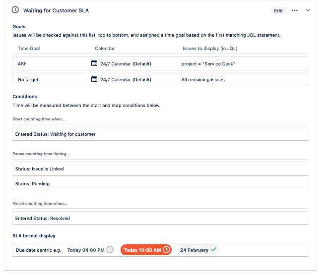

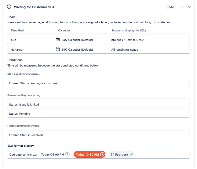

Then I make a 48 hour SLA from within the project as in the appendix.

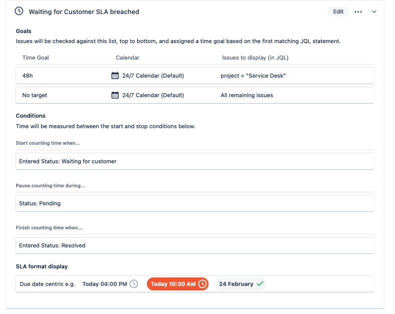

I will automate 2 of them.
Do you see the attachments?
***IMPORTANT***
It only needs to write 48 hours in the SLA tab, right?
***IMPORTANT 2***
The 48-hour period will begin when the Waiting for Customer status becomes available. It will send an e-mail after 24 hours within this period. After 48 hours, the ticket will be resolved.
Is it correct?

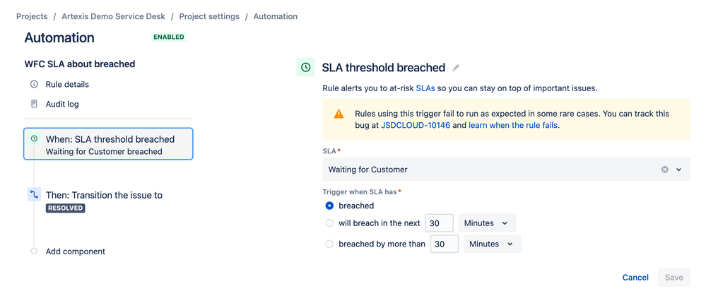

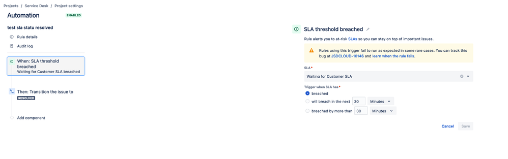

Hi @Barış Özer,
Your SLA configuration seems correct. So does your first automation rule that sends the email. But the second automation rule that updates the issue status to resolved should simply have the first option breached selected.

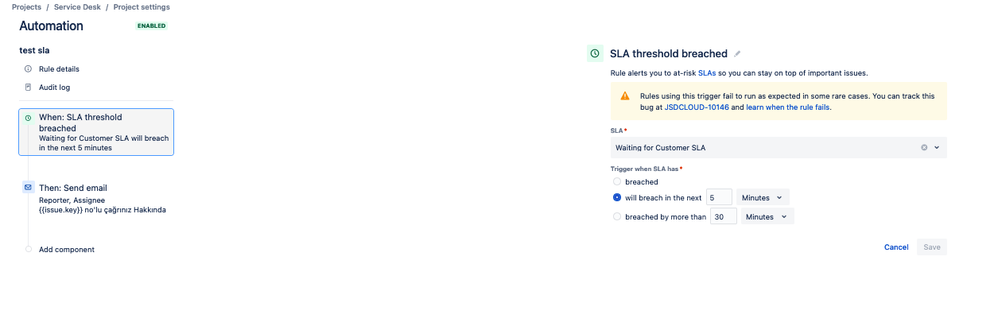

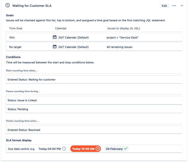

I created it as in the attachment for testing purposes.
But he didn't send an e-mail after 1 minute?

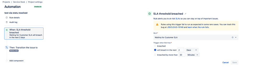

I fixed the 2nd automation.

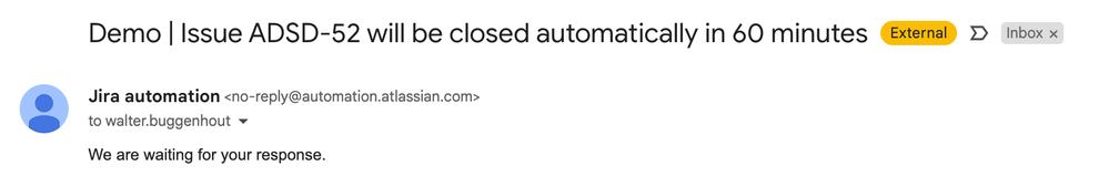

Hi @Barış Özer,
No, obviously not. The email will be sent after 47 hours and 59 minutes. I have the impression that you still don't see how it works 😅.
Your SLA target is 48 hours. That is what you have set in the SLA configuration (your first screenshot). Everything you do in your automation rule trigger is relative to that SLA target. When you say: send an email when my SLA wil breach in 1 minute, that means it will do so after 47 hours and 59 minutes. So just set it to will breach in the next 24 hours and it should work as expected.
For reassurance: here is the email I got from my test site, exactly 1 hour after I moved my test issue to Waiting for Customer:

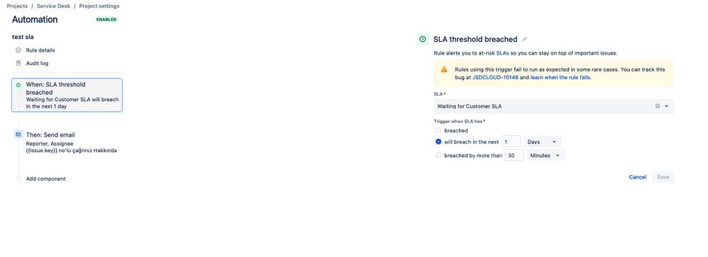

I tested as attached.
10 minutes Waiting for Customer SLA - Automation 5 min next breach and it arrived successfully!! :D
I understand!! (:
It's like we're dividing in half, making a minus? :D
