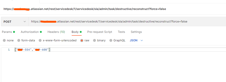

Musienko Anton July 12, 2021
Hello @Petter Gonçalves
Please help with similar situation, when we made SLA we made some mistakes so we repair themes and now we need to recalculate SLA
I try to do like you wrote but I have no changes in SLA and their goals.
I get answer 200 OK and {"successes":{},"failures":{}} is it correct answer?
I send POST like on screenshot
Also we use CLOUD Jira

@RenatoLL @Melik Akoğuz I understand that answer maybe late, but: I try to ask and get this link:
https://confluence.atlassian.com/jirakb/slas-in-jira-service-desk-cloud-are-missing-or-disappear-954252774.html
In this case we see that {"successes":{},"failures":{}} is OK answer.
But in beginning of 2022 year it work correct and now I see that it work sometimes not good :(
