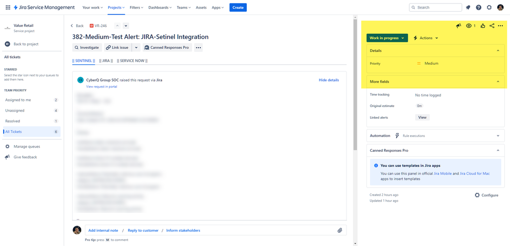

Suddenly, the SLA Panel in issue view disappeared. I checked the issue layout and I noticed that the SLA Panel in the Context Fields is not there! How can I add it back? Thanks.

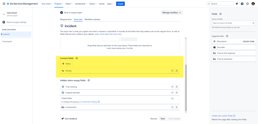

Since we've resolved the issue in the support ticket, I'm sharing the resolution here in case someone else faces the same issue.
We found out that the SLA panel was missing from the Issue View since the SLA panel (system field) was moved to the second tab of the screen configuration. The SLA panel is hard-coded to the default tab and won't work if it's moved to a different tab.
Hope this helps anyone who faces this issue too.

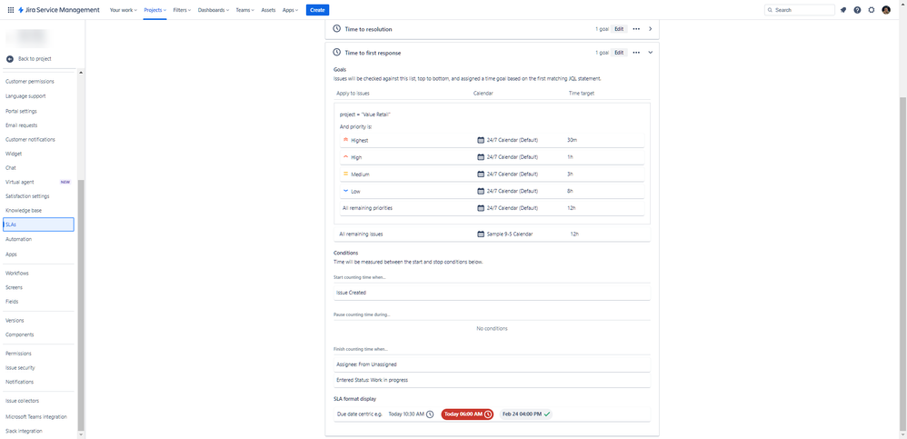

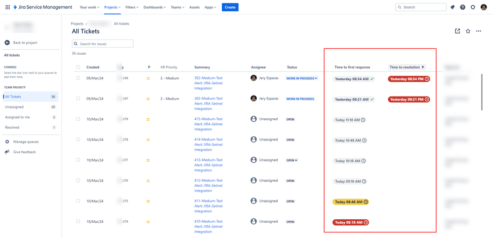

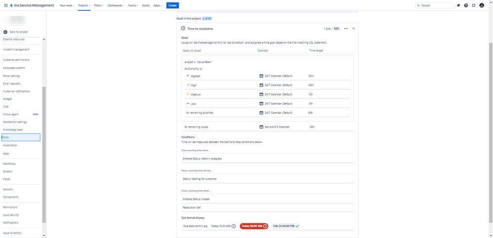

Hi @Joseph Chung Yin - yes it is completed and activated for the project. The SLAs (time to first response and time to resolution actually works and can be seen in the queue but not on issue view.
