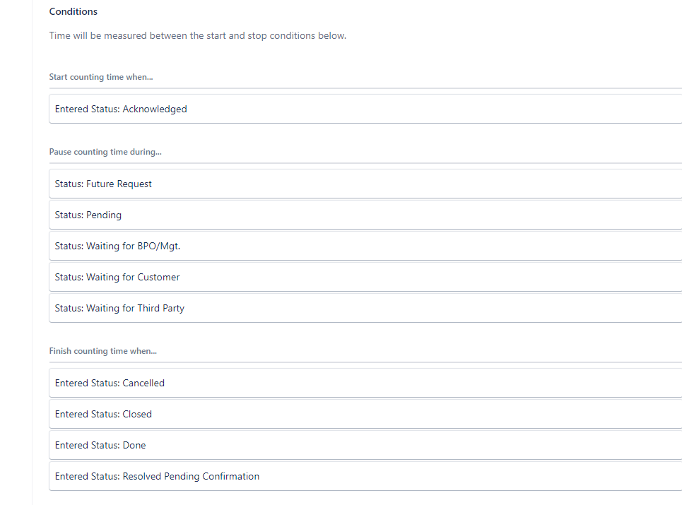

We currently have conditions in place when starting and stopping the SLAs.
Does the above look ok? The part that Im confused about it is that the conditions and SLAs worked fine before. No idea what stopped it from working.

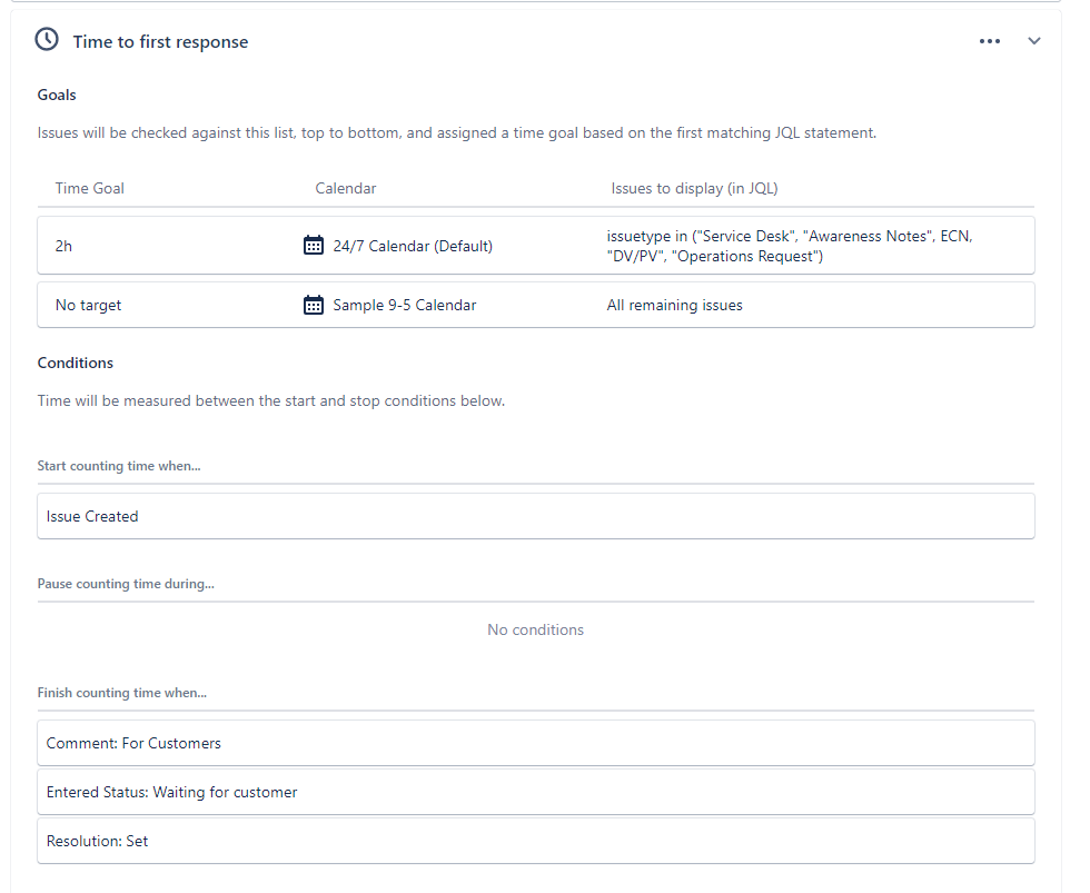

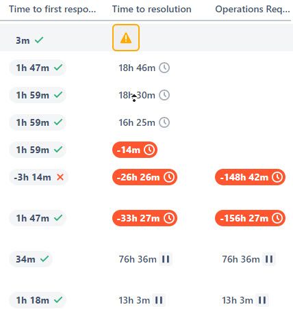

Thank you for your reply. So we have two SLAs for this project. One is "Time to first response" and the other is "Time to resolution.

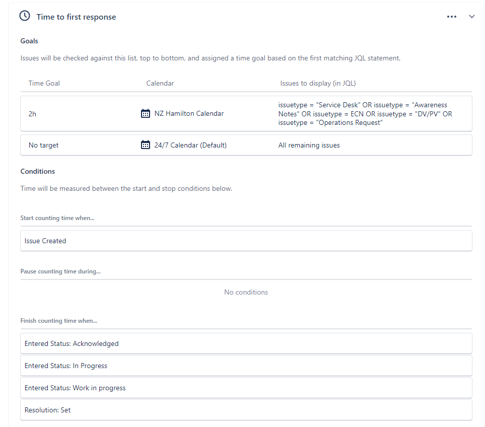

Here is the "Time to first response" SLA and the issue type that it's not populating for is "Operations Request" . Snag_3c56ad9.png

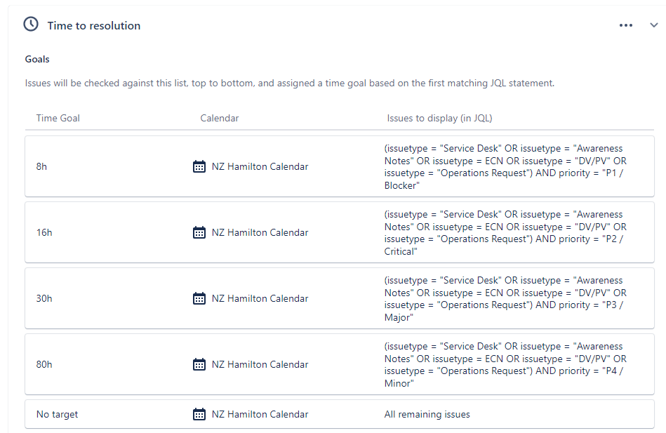

This is the SLA for "Time to Resolution" SLA and the conditions.
I have deleted all the test SLA's I created as they didnt work either.
This is how the queue looks now. I have highlighted the empty fields for the operations request issue type.

I replicated the scenario you are using in the 2h SLA.
The error is in the OR condition of your JQL. For SLA's, when it comes to including more than one value for the same field, we use the IN function and not the OR.
Try using the following JQL in your 2h SLA:
issuetype in ("Service Desk", "Awareness Notes", "ECN", "DV/PV", "Operations Request")
Each issuetype is separated by a quote(") and a comma(,)
I believe that for the first case this will work. Then just replicate the same "IN" condition for the other SLA's.

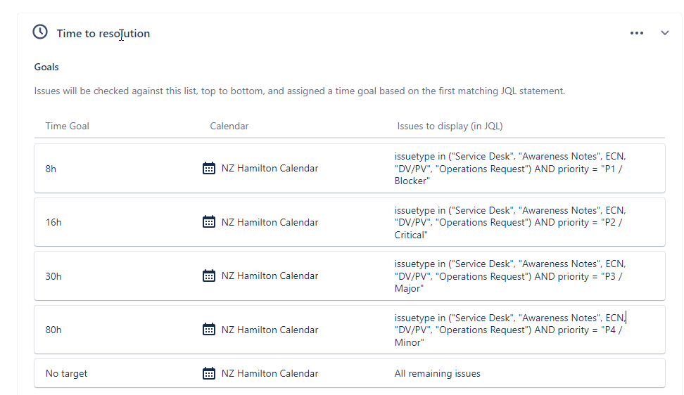

Aamina Reihana
December 19, 2021
HI Fernando
Thanks for that and its partially working.

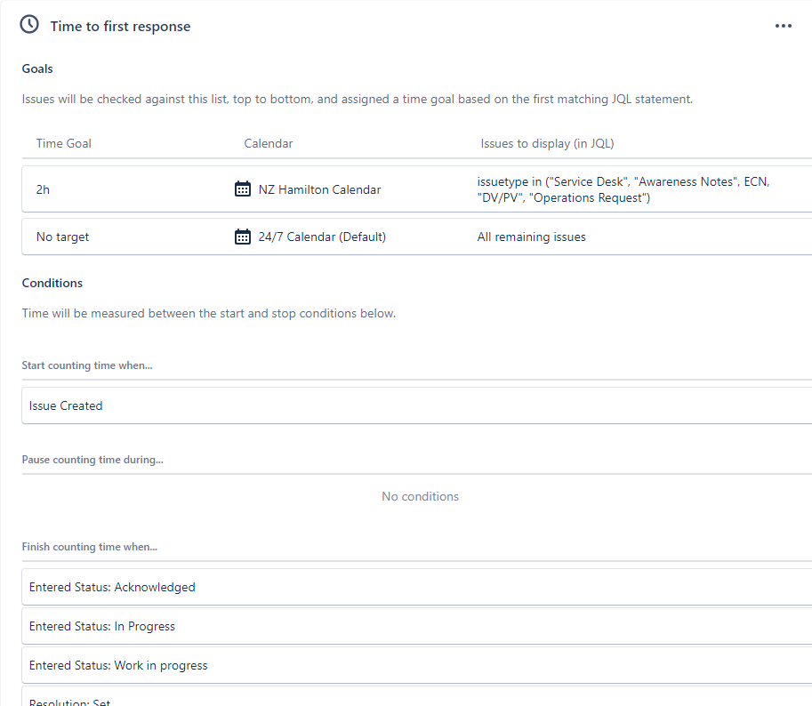

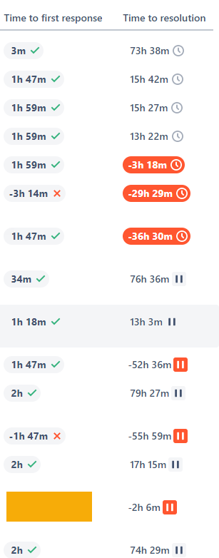

I have made those changes to the SLAs so  now they look like this.  This is Time to resolution and I tried putting quotes around ECN but it kept resetting probably because its one word.  The time to resolution is working but not the time to first response. Snag_18b00078.png
There are two fields for time to first response that aren't populated at all and these are for Operations Request issue type.

Under Star to counting conditions for the First Response SLA, what is included?

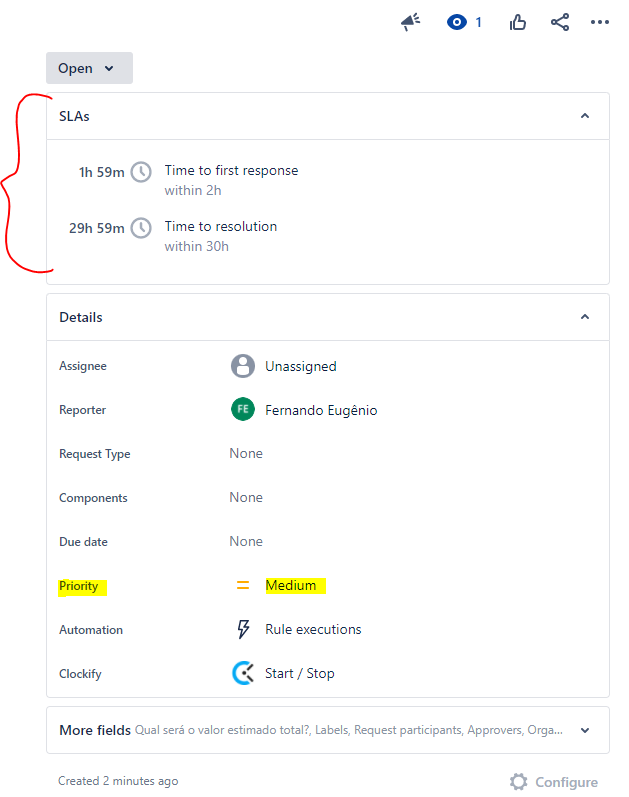

I exactly replicated your rule in my environment and got the following result:
Time to first response:

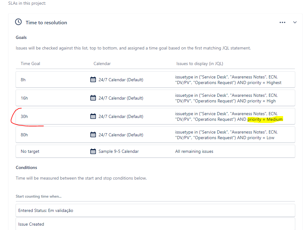

Time to resolution:
See that I filled in the priority as "Medium" highlighted, because that's what I used in the following test:
Perhaps the detail you are needing to have is the "Conditions" to start counting and/or pausing.
Does the Time to first response SLA appear for all, some or no issuetypes?

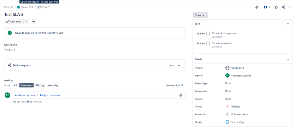

Fernando Eugênio da Silva
December 19, 2021

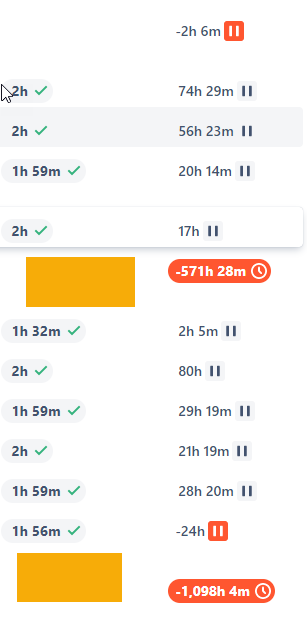

See another test with the Issuetype "Operations Request" and the highest priority.
The value for the time to resolution SLA changed as inserted in the previous JQL, but the time to first response value remained with 2h, as configured in its due SLA.
