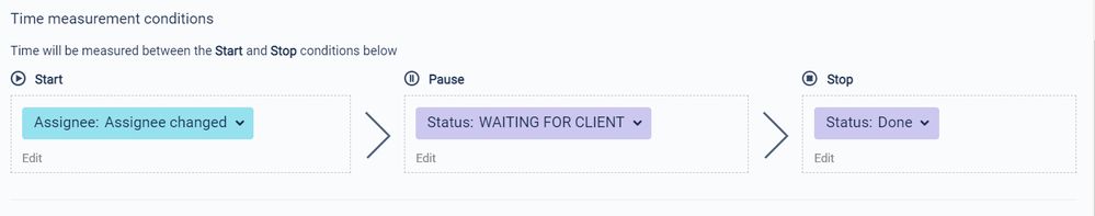

I’d like to recommend you SLA Time and Report, which can help you to set any configuration in Jira.
Define SLA for interacting with external partners with statuses. For example, choose to Start SLA when the task has assignee (Assignee changed from Unassigned to Assigned), Pause with condition ‘Waiting for customer’ and Stop, when the issue is done:
I believe that such tool from the Atlassian Marketplace, as SLA Time and Report, will be a better solution for you for any SLA ideas you have.
