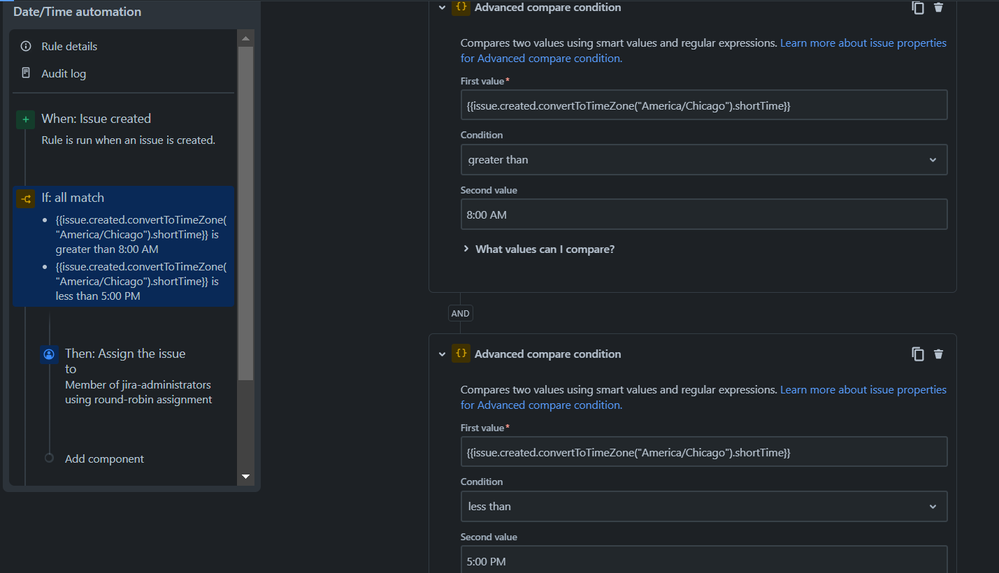

Vikrant Yadav
September 26, 2023
Hi @Sebastián Buzzurro  For this you can apply if condition >> "Advanced Compare Condition", similar to below screenshot.
Similar Post :- https://community.atlassian.com/t5/Jira-Service-Management/Automation-for-Out-of-Hours/qaq-p/2333663

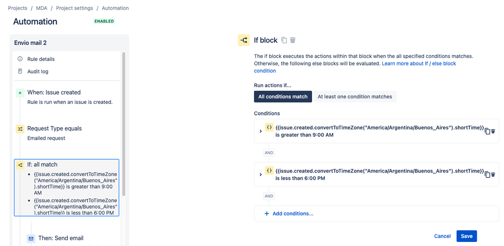

Sebastián Buzzurro
September 26, 2023
Hi @Vikrant Yadav ! Thank you for your response!
I tried to do this, but when I test it, the automation says "No Actions Performed" and the if block did not match the condition.
Now in Buenos Aires, Argentina it is 3:45pm. Maybe the Time Zone is incorrect? Do you know how can I set my Time Zone? (Buenos Aires, Argentina)

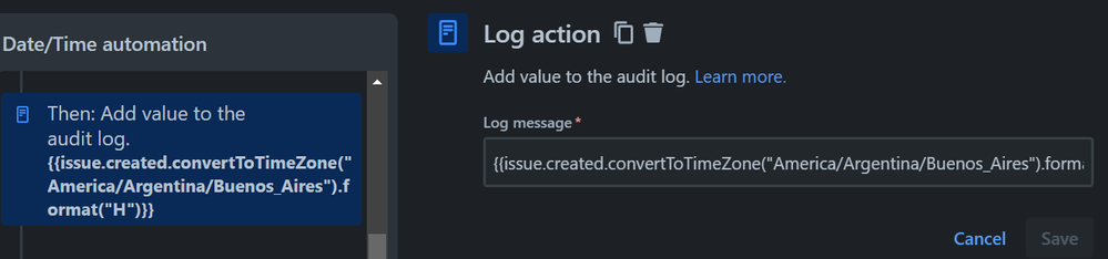

Trudy P Claspill
September 26, 2023
Instead of using the shortTime format I recommend the format that gives you the hour as 0-23.
{{issue.created.convertToTimeZone("America/Argentina/Buenos_Aires").format("H")}}
Then in your If block compare that value as
greater than or equal to 9
less than or equal to 18.
You might also want to use a Log action before your IF block, just to print that smart value into the Audit Log so you can confirm that it is getting the number you expect.
Like # people like this
Vikrant Yadav
September 26, 2023
@Sebastián Buzzurro As said by @Trudy P Claspill Use 24hr format and add Audit Log action to print time, which will helps you in debugging the automation.
Like Sebastián Buzzurro likes this

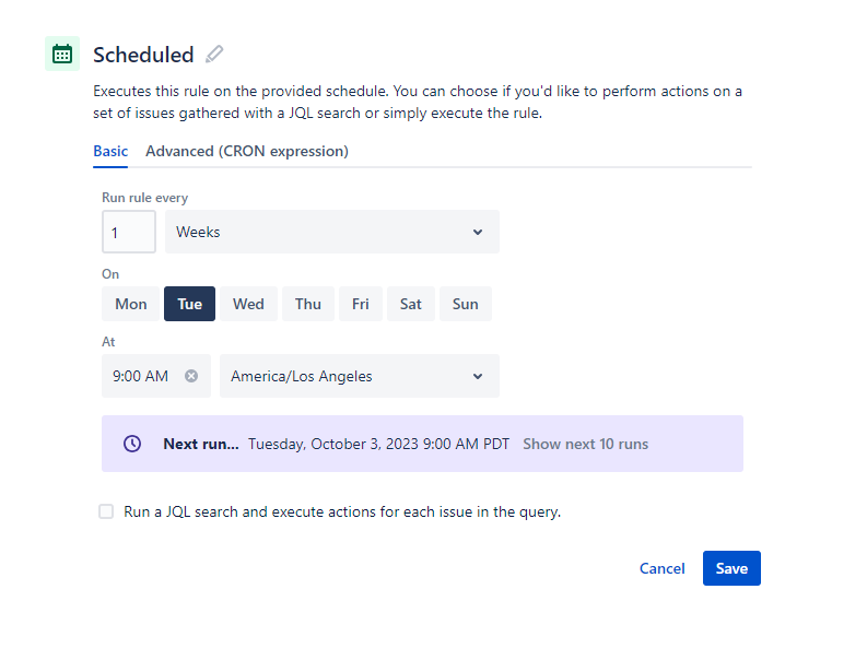

Joseph Chung Yin
September 26, 2023
@Sebastián Buzzurro -
To supplement what @Vikrant Yadav suggested, I am sure that you need to change your rule triggering event to "Scheduled", then establish needed conditions.
This is only way where an automation rule can be invoked at a specific time/days in Jira/JSM projects.
Hope this also helps.
Best, Joseph Chung Yin
Jira/JSM Functional Lead, Global Technology Applications Team
Viasat Inc.
Sebastián Buzzurro
September 26, 2023
Hi @Joseph Chung Yin ! Thank you for your response!
I understand you, but I need it to run when a ticket is created during a specific time only :( So the trigger must be Issue Created and then the condition of specific time to run.
