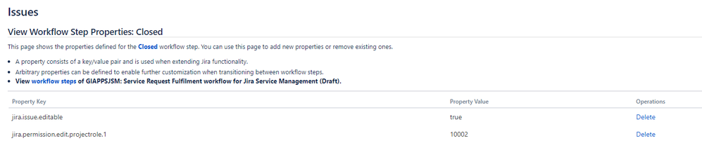

Another option for you, if you have an issue at the "CLOSE" status, but you still want to edit the issue.  You can also change the property of the "CLOSE" state to allow edit issue only to the project administrator role members.  NOTE - In this situation, it is assuming that there are no further transitions going out from the "CLOSE" status, and you cannot edit the issue because typically once the issue is closed, then it is locked down for further editing.
Hope this also helps to your ask.

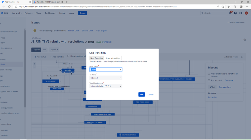

Dirk Ronsmans
February 7, 2022
@Jisu Jung ,
Correct, Normally in JSM a Close status is a final status. So to be able to modify that you'll have to add a transition between the Closed status to the status you which to go back to.
Perhaps adding a condition on it so only a specific group can do it would be a good practice. (like an Incident manager)

So, This is what I'm thinking to do now with Workflow
How do you think?
Jisu Jung
February 7, 2022
Would like to make "CLOSE" to somewhere in the middle of our process (ex. INBOUND)
Please let me know how it seems like,
and please let me know how to activate the modified workflow,
