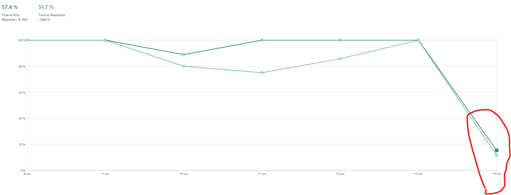

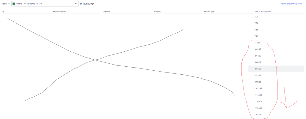

Both Time to first Response and Time to Resolution have problems with old tickets suddenly breaching with thousands of hours.
Our report (Pic. below)

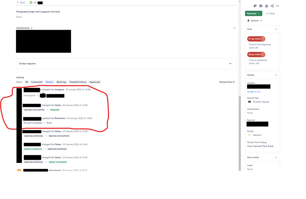

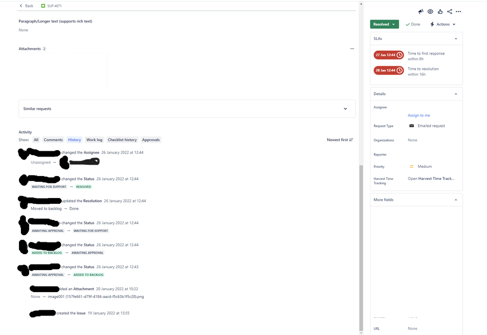

An example of one of the breached issues that suddenly is breached on current day on the report, that has status resolved and resolution "Done" (pic. below)

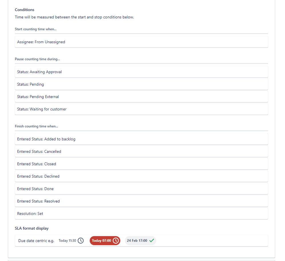

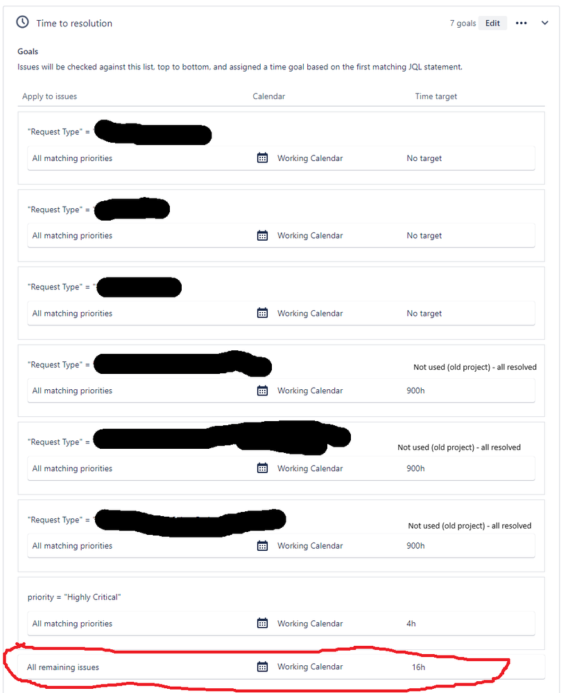

Our SLA - Time to Resolution (2 pics. below)

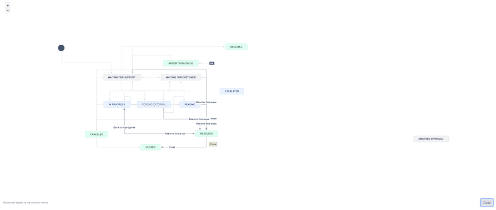

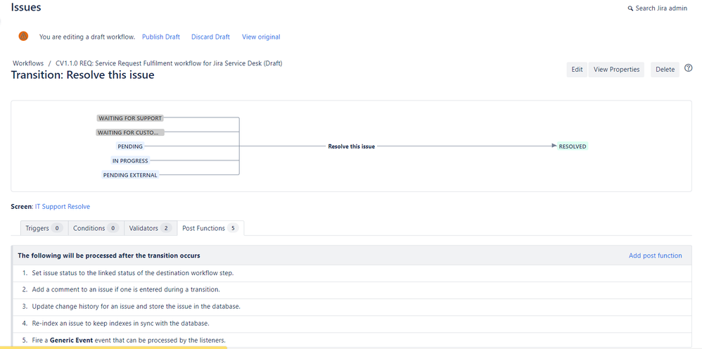

Workflow (pic below)

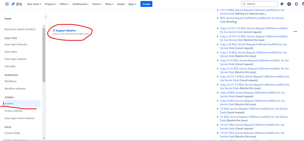

But if the result would be "Resolved" issues with the resolution as "unsolved", wouldn't it show on upper right side of the ticket (as shown in the 2. picture example up in the description^^)?
Where do I see if I missed the resolution on screen?
If I look on screen, I can't seem to find it.

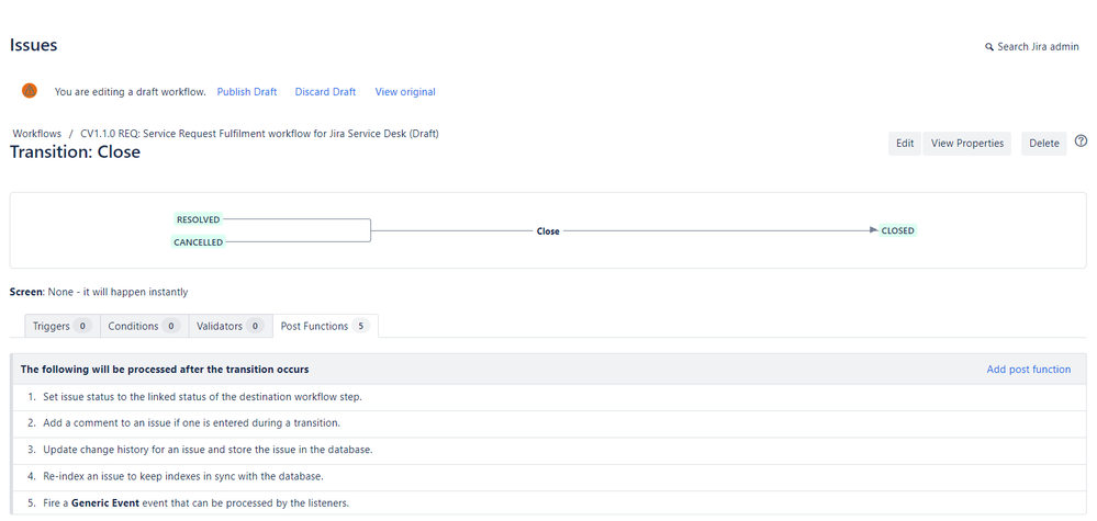

It has not anything to do with post transitions?

Try using a JQL search to filter issues that are in "Resolved" or "Closed" status with a resolution of "unresolved".
This should at least show you if anything matches that theory, if it does, you have your answer if the issues that are breaching and both match the JQL appear.
BTW if you move to resolve an issue, are you presented with an option to choose a resolution?

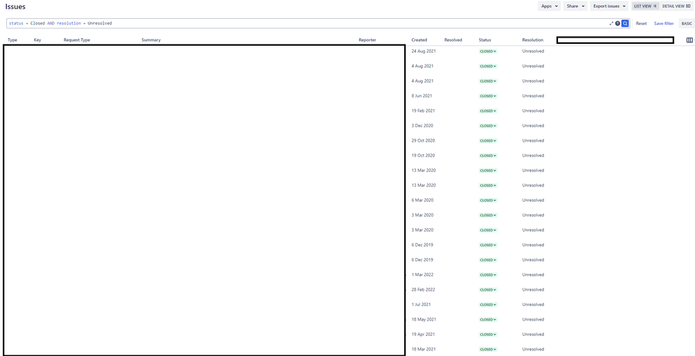

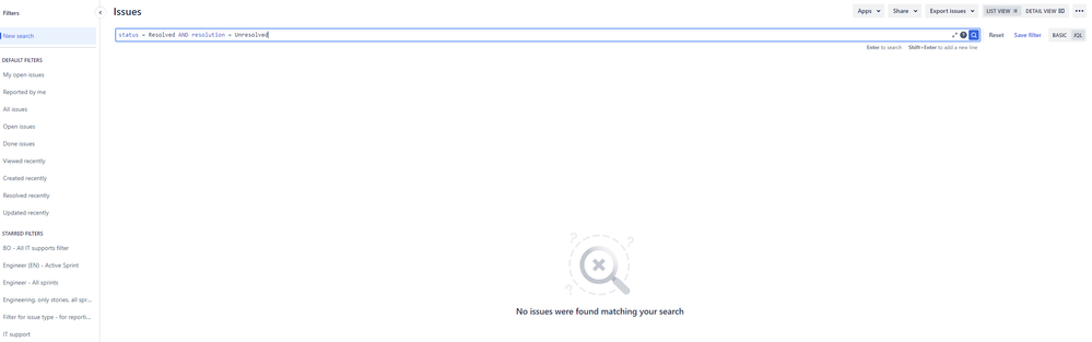

I try the filtering with status of closed and resolution. But could not find anything.
CLOSED (below)
Some tickets came up, but it is not the same as the one that are breached. At some point we used the "close" status, but does not anymore.
Resolved (Below)
Fuji
June 24, 2024
The only pattern I found with the breached tickets, is that in all of them the assignee is assigned after the resolved status and resolution of done are set.
Below is an example of that.
Although it does not make sense to me, that this should be the reason?

For starters I'd fix the issues that are closed with unresolved resolution, that's a reporting headache within itself.

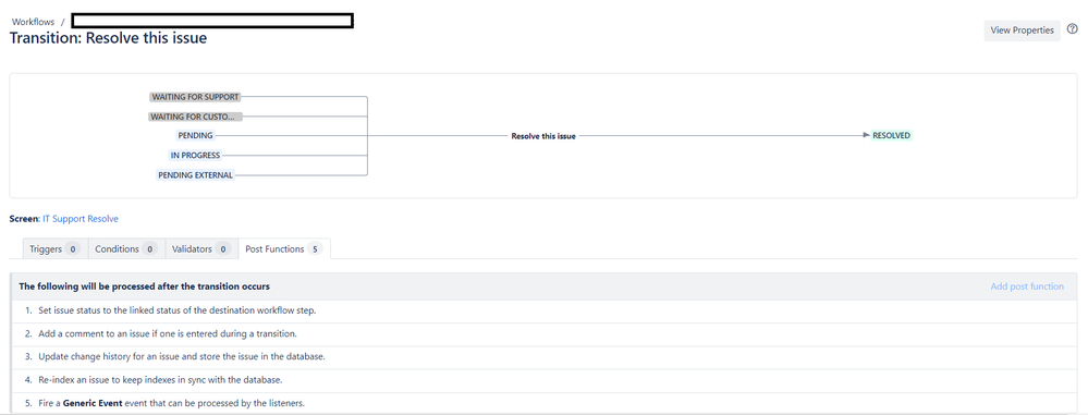

Second, have you got any automations running or custom post-functions in the workflow? Anything that re-triggers a workflow transition on assignee for example?

Fuji
June 27, 2024
These are the only post functions in our workflow I can find.

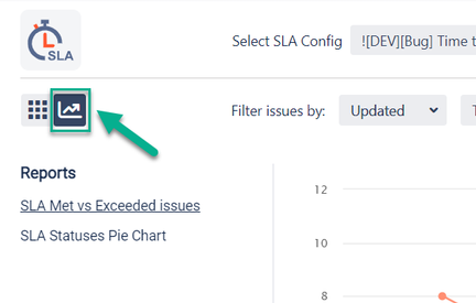

Try our SLA Time and Report add-on for Jira with SLA Chart Reports.
How it works:
You can get a helicopter view of necessary issues’ SLA statuses using graph reports at SLA Time and Reports. Just click the icon at the left top bar.
You can view data by using 3 kinds of chart views:
  • Pie Chart (SLA Met/In Progress/Exceeded)
  • Line Graphs (SLA Met & Exceeded)
  • SLA Met vs Exceeded per Assignee
SLA Met & Exceeded issues
Line Graph of SLA Met & Exceeded issues — shows dynamic and statistic data of met and exceeded issues for SLA config’s goals.
The chart shows detailed information about the number of issues that have met and exceeded SLA goals. Also, you can exclude SLA goals to view chart data without them. If SLA Config has more than one SLA goal, the data will be displayed about each one.
For this type of report you can select the frequency of splitting data on the chart: daily, weekly, or monthly.
