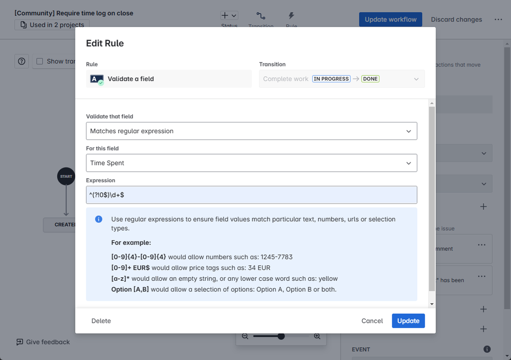

I managed to get this to 'partially' work with Validate a field validator and by using "Match regular expression" option. I'm looking at the "Time Spent" field and by using the following expression
^(?!0$)\d+$
Now, I say partial as this will not work if you try to log time during the transition itself > meaning, all users would need to log time before making a transition.
I'm not sure if that's a viable option or not for you but I hope it helps.

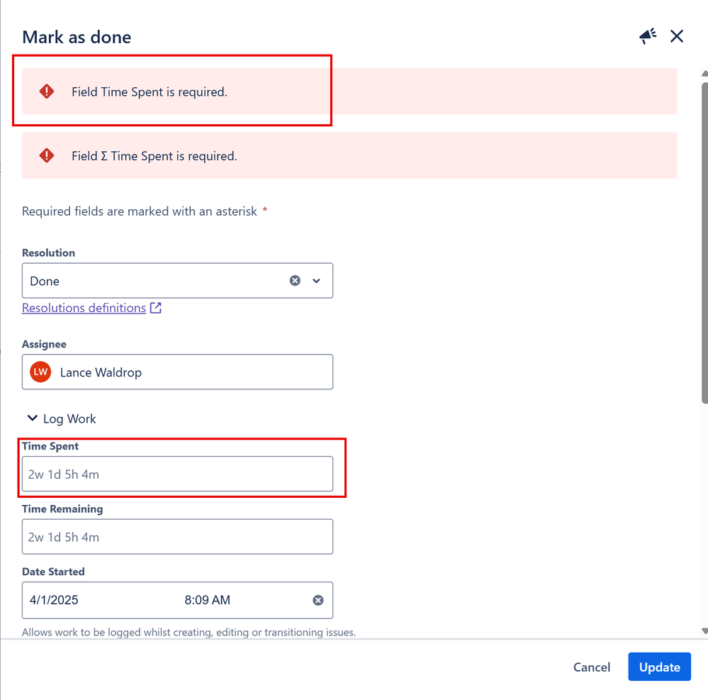

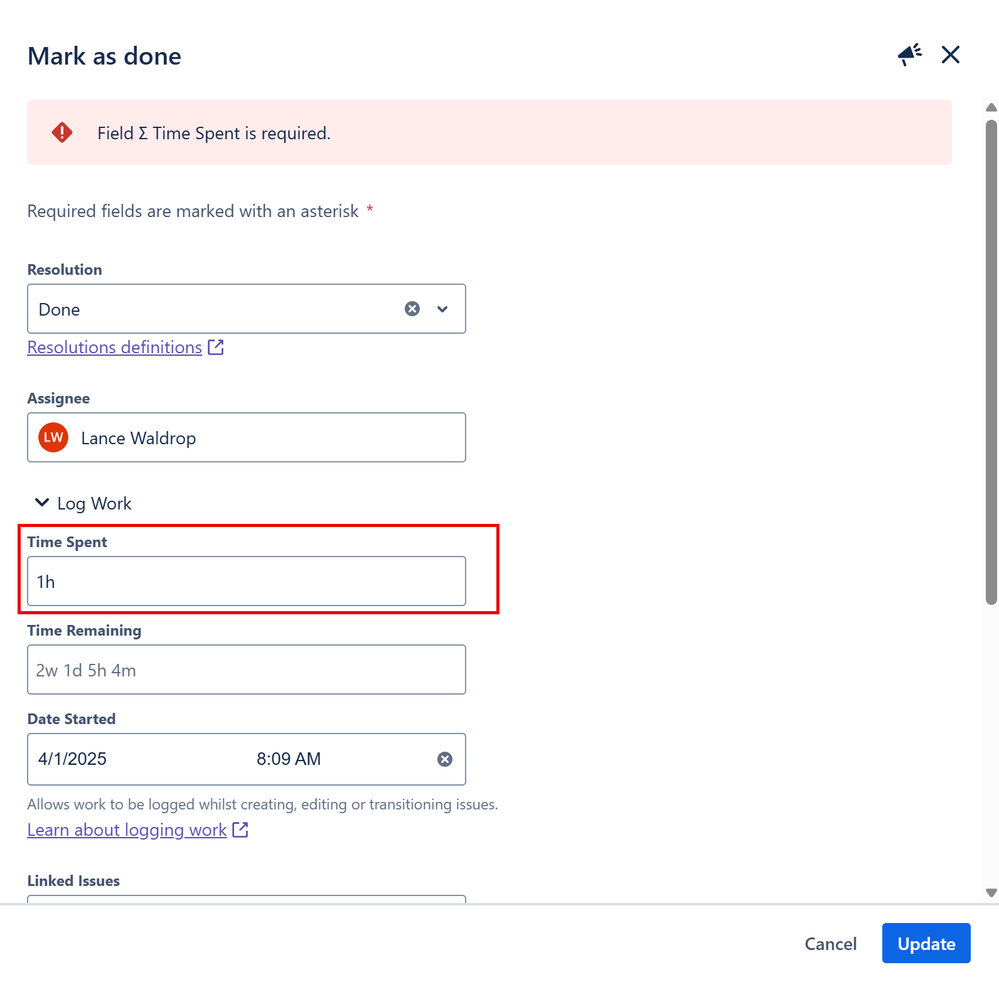

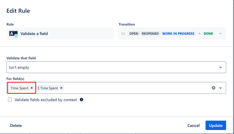

Thanks @Tomislav Tobijas for responding. I gave that a shot and it didn't work like I was hoping.
I'm still interested in anyone suggestions but at the moment I'm leaning toward dropping 'Σ Time Spent' and just requiring 'Time Spent' on close and if they have to log hours a one additional time then so be it. Here are some screenshots from our sandbox with what's currently required and how it looks and highlighting the option I'm leaning toward using. Maybe it'll help brainstorm another suggestion:
@Lance Waldrop if you ask me, I would maybe remove ∑ Time Spent field from the validation and leave just Time Spent together with that field being on the transition screen (if that's what is acceptable to you).
