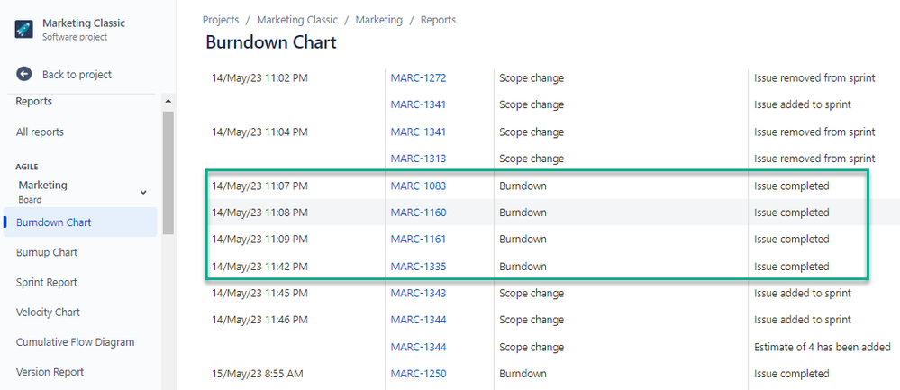

1. Burnup or Burndown report. Both provide information on when the issue was competed.

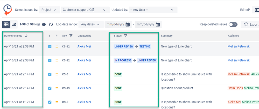

2. Issue History for Jira app. This plugin records all issue changes, including statuses, in a separate column.

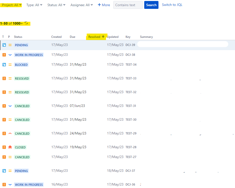

Dave
May 17, 2023
Hi Hannes,
Thanks for the advice -  I checked out the Resolved field  in a filter for all our projects, all statuses and all ticket types. Unfortunately they are all empty as shown in the marked up screen shot below, (Summary hidden)
Being newish to the Admin side of things - I would have wished that it was easy to select the Resolved field.
My previous manager set up our projects, in hindsight I suspect they must have thought the updated field would have worked.
Any further advice is welcomed.
