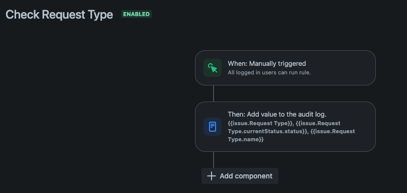

In short i'm trying to use requestType in Automation.  Its always coming blank.
Here's what i've tried:
Project: Team managed JSM project
Created a test automation to run as an action on the issue:

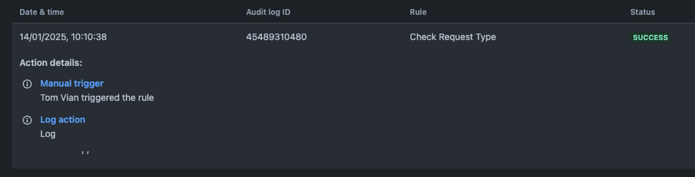

On checking the audit log after triggering - no values are returned:

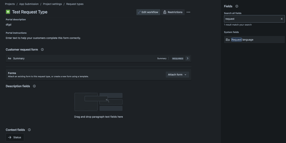

One piece of advice i found is that you cannot use requestType in automation if it isn't in your edit screen.  This is a team managed JSM project and as such you can't add the requestType on the edit screen.
I've checked on the project settings > request types > add request type > Fields - and request type isn't available to add.

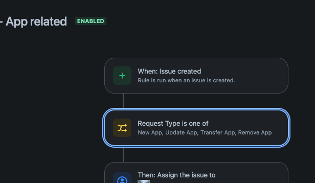

I've just noticed we have automation working in a different project for request type that is working.

Further to this we do have request type in the custom fields but this is used in a different project.Xnip2025-01-14_10-28-41.png
