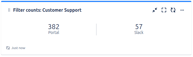

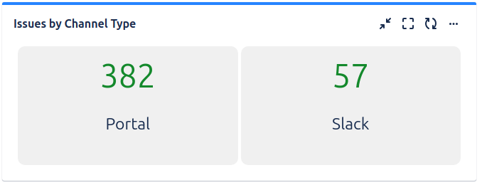

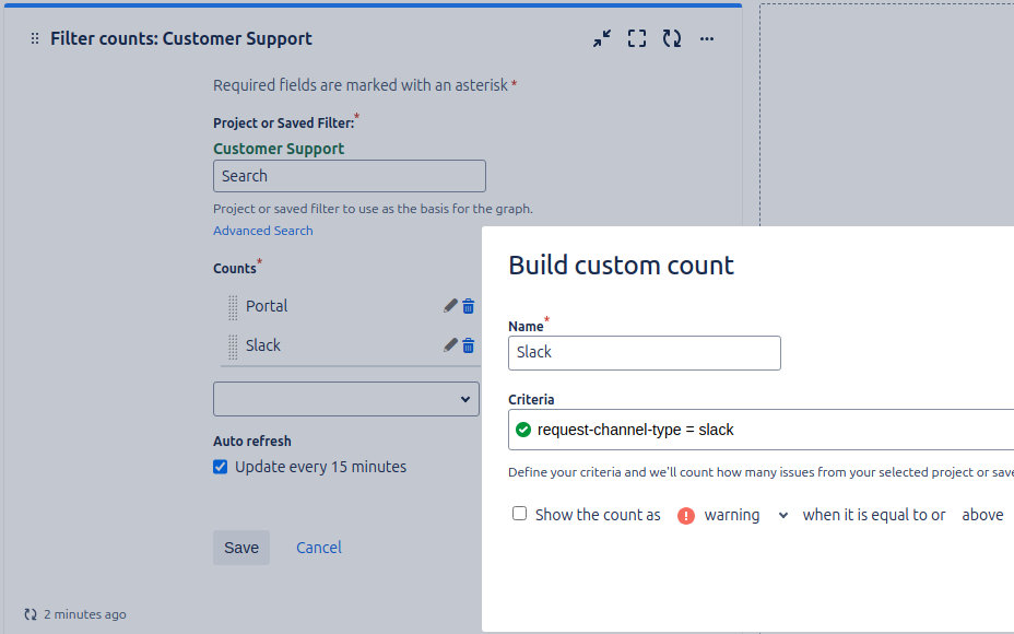

Hi @Ender P_,
You could also use the Filter Counts gadget of Jira Service Management configured with the "Build custom count" option to display all the counts in a single gadget.
The result will be like this:
In case this gadget is not available, a similar view can be achieved by using the Advanced Issues Filter Formula gadget of our Great Gadgets plugin:

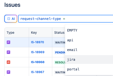

Ender P_
January 10, 2025
Thank for this Anahit - I'm not seeing Slack for some reason, would it go by another name?
API I'm assuming?

Anahit Sukiasyan
January 12, 2025
Hi @Ender P_
Thanks for sharing the screenshot!
I guess Slack is not shown in the list as its' integration is not fully configured and it might need additional configuration for the issues to reflect Slack as a channel.
To check that you need to confirm from Apps section, that the Slack app/integration is properly installed and linked to your Slack workspace.
