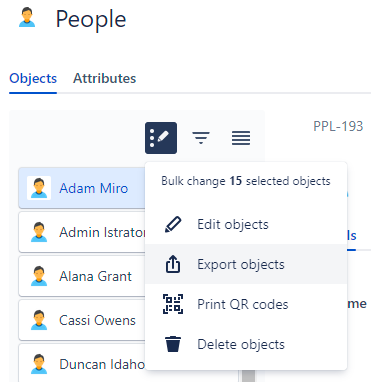

On the Premium plan, you are able to export Asset data from the bulk actions menu when viewing an object type. This will allow you to configure the structure of your export as well.
If this does not fit your needs I would recommend searching the Marketplace for an Asset Reporting application. Unfortunately, I cannot speak to any app in particular.
