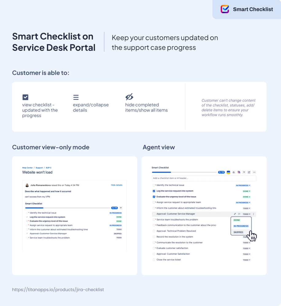

If your team wants to avoid the overhead of creating separate sub-tasks for each actionyou might want to try Smart Checklist for Jira.
As the representative of the tool I can recommend Smart Checklist for Jira Service Management workflows, and here’s why:
Smart Checklist Benefits:
  • Create structured action lists within any Jira issue (Problem, Incident, Task)
  • Assign statuses like “To Do,” “Blocked,” or “Done” to each action item
  • Use templates to standardize problem investigations
  • Save time by avoiding sub-task clutter
  • Keep agents and stakeholders aligned with clear, trackable checklists
JSM Portal Integration:
Smart Checklist also supports view-only visibility on the JSM customer portal: customers can see action items, expand details, and track progress
This allows your internal team to manage actions using a checklist, while external stakeholders (e.g., clients or partners) can track status via the portal.

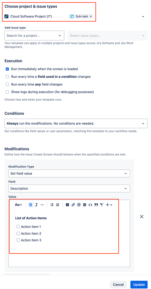

Hi @Kim Galway ☺️, If you're open to using a third-party app, Templating.app is a great solution for automatically adding action items to subtasks.
  • Use description templates to define action items
  • Automatically apply them to subtasks based on your chosen conditions
You can find us at the Atlassian Marketplace ➡️ https://marketplace.atlassian.com/apps/1224664
This is how this can look like:
