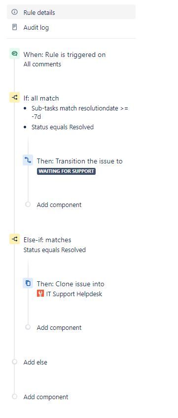

Phil Buckley
January 27, 2023
Thanks Jack,
I put an If and an Else-if in place to Clone an issue, it looked to work ok however now when closing a ticket it re-opens. I guess the first rule is causing this.
What should I change the first step to be?

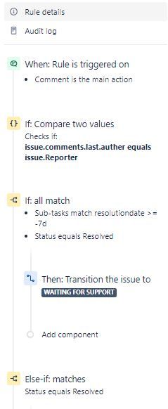

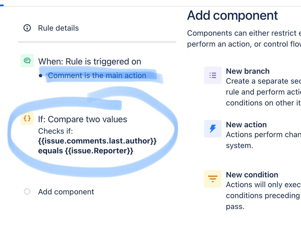

Jack Brickey
January 27, 2023
Ok so you are missing one key condition that is at heart of your goal...
"Rule is run when a new comment is added to an issue."
I am assuming that you actually only want to execute the actions if it is a comment by a customer, correct? That is you don't want to execute these actions if one of your agents happens to add a comment since they could simply reopen it if they desired.
assuming so change your trigger as shown and add the condition just prior to your if/else
Now, if you do wish the rule to execute if an agent comments then leave off the extra condition.

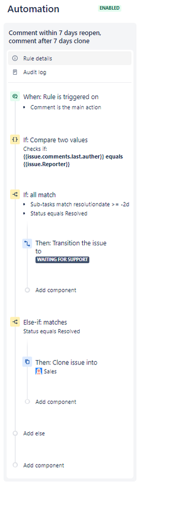

Phil Buckley
March 3, 2023
Thanks Jack,
Well... I think I have it configured correctly but it is not working in a test project.

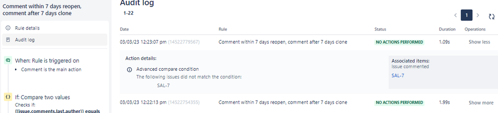

Jack Brickey
March 3, 2023
Please provide a screenshot of rule and audit log showing where things are going wrong.
Phil Buckley
March 3, 2023
Currently set to -2d for testing purposes.

Jack Brickey
March 3, 2023
I think you have a grammar issue here... "auther" should be "author".
One tip I suggest when creating/testing rules is to use the Log action. For example here you could log the resolutiondate just prior to the Compare two values. Then in the audit log it records the data for easy viewing.
Phil Buckley
March 3, 2023
Your right.... grammar issue. Its working now.
