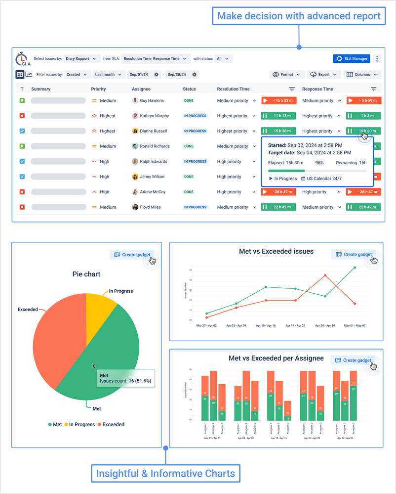

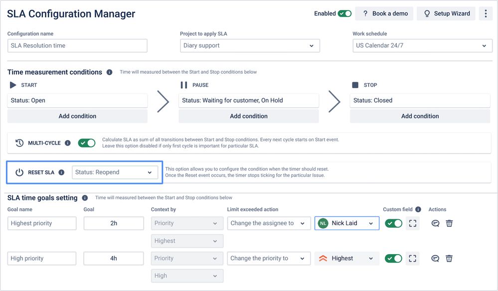

To solve this, I recommend trying SLA Time and Report, an app developed by my team. It allows you to recalculate SLA values even for closed tickets.
With this app, you can:
✅ Use the “Reset SLA” feature to apply SLA logic to older issues
✅ Configure SLA goals and conditions + run recalculation
✅ Include resolved/closed issues in your SLA reports
✅ Track and analyze SLA compliance across your full ticket history
Let me know if you'd like help setting it up. I'd be happy to assist! 😊
